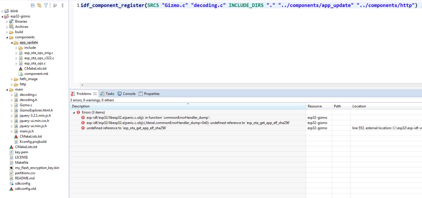

I'm trying to compile my project from old v3. 2. 2 to v4. 0
My project has a components directory with changed code for app_update. Now I get errors in 4.0

how can I replace a file in esp-idf with a modified file? When I replace the file directly in the heart of the asp-id everything works , but when I make the components\app-update folder in my project , the compilation goes wrong. I want to have modified files outside of the esp-idf core so as not to erase them when updating the idf.
in esp-idf-v3. 2. 2, this method worked.

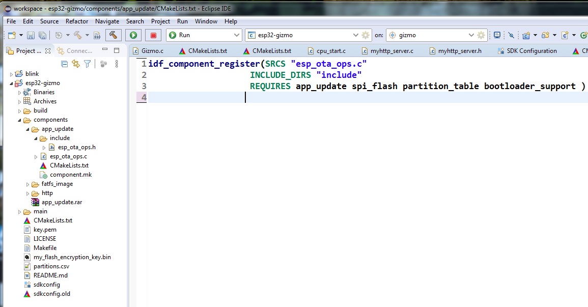

Your CMake variables aren't quite right. Have a read of this: https://docs.espressif.com/projects/esp ... ystem.html
INCLUDE_DIRS is for specifying where to find that component's header files; use REQUIRES if there are other components required by this one.

I'm trying to replace the IDF file by my modify file
esp_ota_ops.c
what I specified wrong in Cmake ?

Hi brp,
It's not possible to replace individual files in ESP-IDF without editing them in the IDF directory, but it is possible to override an entire component by placing it in the project components directory (as you've done). The overridden component replaces the IDF one of the same name.
The solution to fixing the linker error for the missing esp_ota_get_app_elf_sha() function - added in newer version - may be to copy the new esp_app_desc.c file from $IDF_PATH/components/app_update/esp_app_desc.c into (project)/components/app_update/ . Then add the new filename to the SRCS list in app_update/CMakeLists.txt so this file is built in your project. Then the esp_ota_get_app_elf_sha symbol will be available at link time .
If this doesn't work, you may need to make a whole new copy of app_update from IDF v4.0 and then re-apply whatever patch(es) had been applied to the v3.2.2 app_update to the new copy. Do you mind if I ask what did need to change in this component for v3.2.2? There might be an alternative solution that we can suggest.
