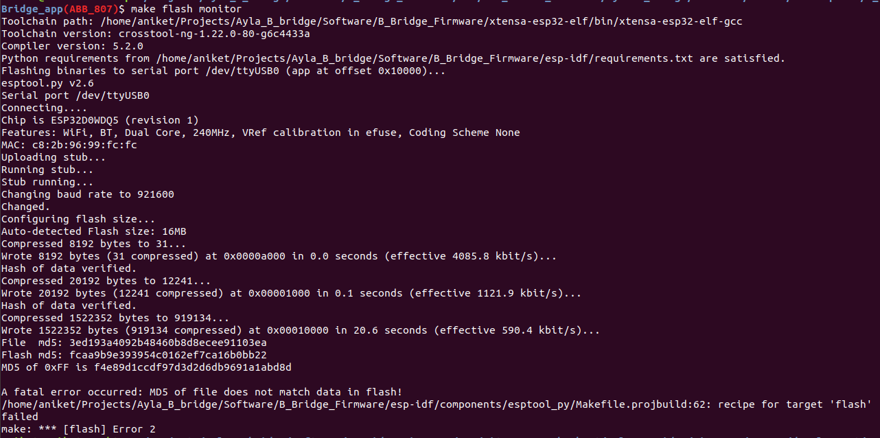

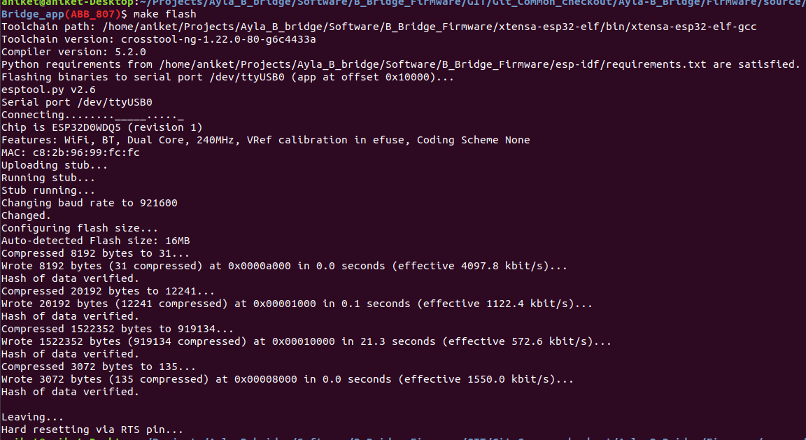

Hi all,
I have removed the shield(upper cover) on the ESP32-WROVER module and replaced the internal 4 MB flash with 16 MB flash(CYPRESS S25FL127S) to increase the esp32 module flash size. when first time flashing this module then module successfully flashing and working fine, but when I flash the second time then module gives MD5 error in the console log.
But when I erase the entire flash and then upload the code It works fine.
ESP32 module Flashing Log:-
First time flashing log
Screenshot from 2020-03-11 16-33-46.png (127.53 KiB) Viewed 5418 times
Second time flashing log
Screenshot from 2020-03-11 16-29-33.png (131.84 KiB) Viewed 5418 times

Not sure if we support that flash; it may have a different sector erase command. If it does, erasing flash 'on the fly' like what happens when you over-write flash won't work and you will get data errors.

Hi ESP_sprite,
Thanks for your quick reply, currently we have changed 16 MB flash from CYPRESS S25FL127S to Winbond W25Q128FW then I have tested the device. It's working fine.
