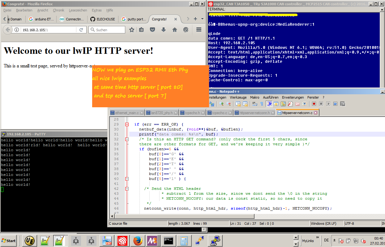

since we have the RMII on ESP32 working and we drive a Eth Phy Nic,
the pull request is done,
we can now do "same" doings like we do with services on wifi.
we can example run on the Eth Phy a web server, echo server, udp server .. and more
we can play with all lwip examples very easy.
found a repo as example here
there are more lwip examples on internet, try to search for "lwip examples"
i push a picture from my desk , sry for craz output, but we are in work alkoholic now

you have now a http server and a tcp echo server on eth phy rmii from esp32
how cool is that ?
hope the info is welcome and helps
now we go on to build a gateway.. :)
