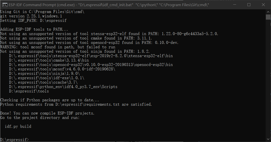

When I start ESP-IDF, there is a warning: "tool mconf found in path, but failed to run". If anybody knows how to sovle it?
Thanks.

are you able to run it manually, i.e.
mconf-idf.exe -v
when you start up the command line or when you go to the directory where it is placed?

Please note also that there is a newer version for the v4.0 you are using: https://github.com/espressif/esp-idf/bl ... .json#L274. It might fix your issue.
