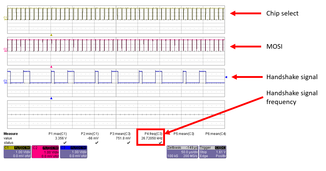

Problem: It worked with the limitation that only every 4th to 5th sample was read. I checked this by hooking the handshake pin from esp32 to an oscilloscope. The measure frequency was around 25 kHz, as can be seen here:
ESP32 25 kHz beschriftet.png (138.2 KiB) Viewed 15346 times
When uncommenting the printf line it showed that the read data was correct at least (even though the frequency was further reduced due to additional communication, of course).

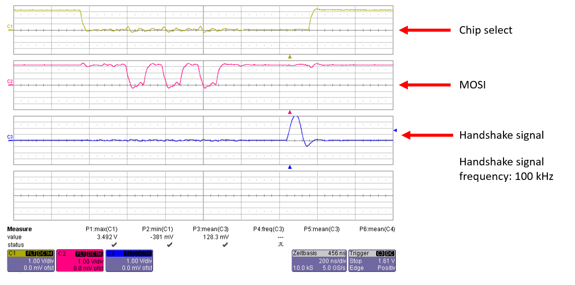

It is to the point now where the interrupt triggers successfully after every sample:
CS MOSI HANDSHAKE beschriftet.png (131.9 KiB) Viewed 15346 times
The esp32 also puts out correct data at the MISO pin (I only implemented this for debugging).
Problem: It reads 0 from SPI_W0_REG all the time. I checked this by uncommenting printf line in while loop again.
Question: What is missing/wrong in the code above so that it reads 0 instead of the expected non-zero data?
