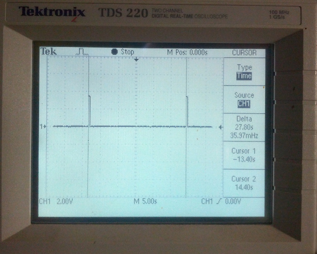

OK, I have taken the ledc example and applied Occam's Razor to get a bare minimum example. I believe that it's short enough to simple paste here. This time I get no PWM at all. What I do get is a flat line LOW level with a HIGH pulse of 0.5 second duration every 37 seconds.
Since my last post I created a fresh clone of the SDK to make sure that it wasn't in some strange state.
Here is the code:
Here is the code:

murray_lang
- Posts: 24
- Joined: Fri Oct 07, 2016 4:43 pm
Re: ledc example does not work at all
That was with my Nano32 board. I get the same result with my WROOM-32 except that the period between the pulses is nearly 28 seconds.]

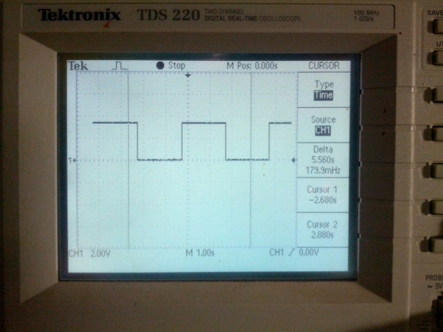

You probably need to add a call to ledc_update_duty(mode, channel) after the call to ledc_set_duty.
http://esp-idf.readthedocs.io/en/latest ... _channel_t
If you check the LEDC example, you can see this being done after the "printf("LEDC set duty without fade\n");" line
Thanks iggr
That explains the difference in behaviour between the above code and my previous tests. However, remember that I tried the ledc example verbatim.
Anyway, I added the ledc_update_duty() calls to the simple test above and I am back to the original problem. Scope trace is attached. Note the time scale.
