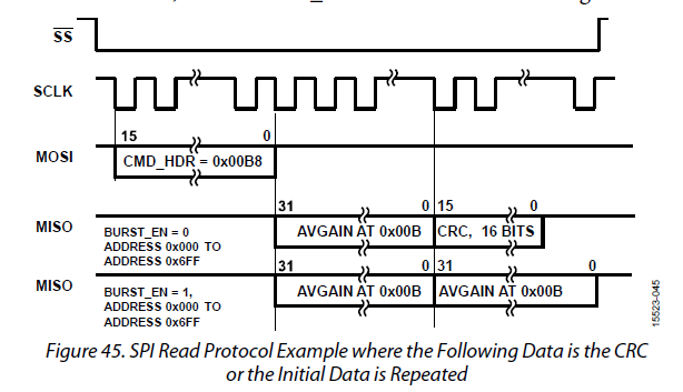

Can you please give me ans of few questions:
I am trying to read version of ADE9000 chip for SPI communication with below code
uint32_t ade_get_version(spi_device_handle_t spi)
uint16_t Address = 0x000004FE; //Address of read ADE version 16 bit address
uint16_t temp_address;
uint32_t returnData;
// gpio_set_level(PIN_NUM_CS, 0); // no necessary to handle chip select pin
temp_address = (((Address << 4) & 0xFFF0)+8); // this done in arduino library code
spi_transaction_t t;
memset(&t, 0, sizeof(t));
t.length=8*4; //length of recive buffer in bit
t.cmd = temp_address;
// t.tx_buffer=0;
t.flags = SPI_TRANS_USE_RXDATA;
esp_err_t ret = spi_device_transmit(spi, &t);
assert( ret == ESP_OK );
// gpio_set_level(PIN_NUM_CS, 1);
printf("ADE9000 VERSION all bytes: %02X%02X%02X%02X\n", t.rx_data[0],t.rx_data[1],t.rx_data[2],t.rx_data[3]);
printf("ADE9000 VERSION before: %08X\n", *(uint32_t*)t.rx_data);
return *(uint32_t*)t.rx_data;
This code return ADE9000 VERSION: EF097F00 but vesion is FE13DE
In datasheet given SPI waveform I have attached here.
Questions:
Is my code snippet is looks correct?
If any changes is need where I need to change?
Thanks for your support..!!

In
    t.length=8*4;
    t.user = (void*)1;
try setting the t.rxlength to a specific number fo bits. If u want all 4 bytes of USE_RXDATA then set it to 32. Maybe this can help.
I looks like u are confusing the transmission data length (t.length) with the receive length (t.rxlength) buffer for receiving.
As I see it, the SPI will try to SEND 32 bits from the t.tx_buffer (not set in your code) and receive 0 bits into the internal 4 bytes buffer (USE_RX_DATA).
BTW, bzero(&t, sizeof(t)) is faster...
Hope it helps.
