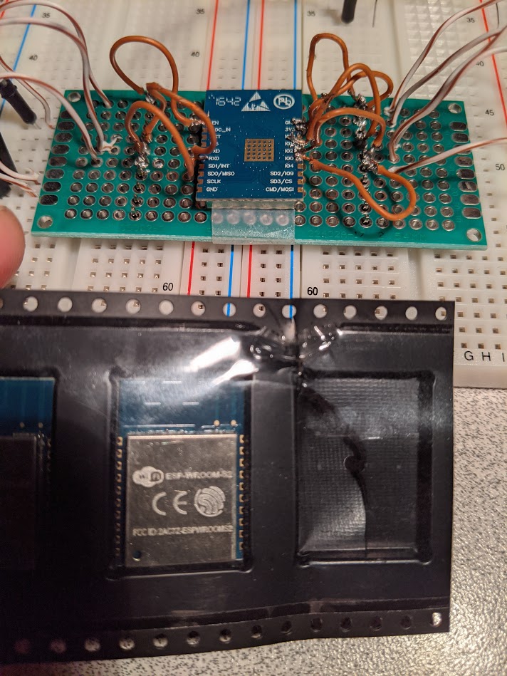

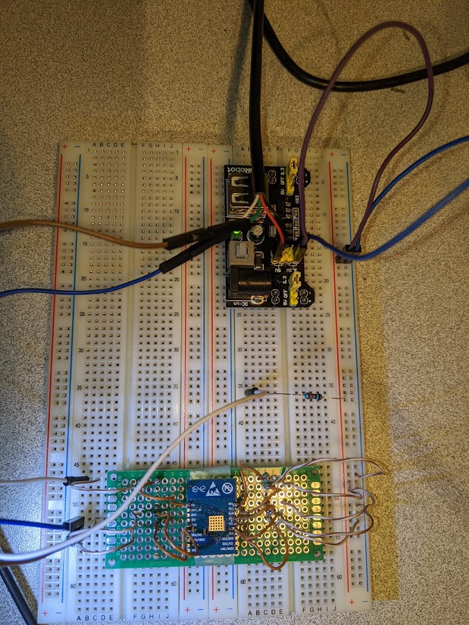

Postby alekmarinov » Sun May 17, 2020 12:05 am
I connected the pins to set the device in download mode (see the image bellow) and run the flash command for hello_world as bellow:
Code: Untitled.bsh Select all
~/Tools/esp-idf/hello_world$ idf.py -p /dev/ttyUSB0 flash
The command ended with attempt to connect but without success.
[782/783] cd /home/alek/Tools/esp-idf/components/esptool_py && /.../home/alek/Tools/esp-idf/components/esptool_py/run_esptool.cmake
esptool.py --chip esp32s2 -p /dev/ttyUSB0 -b 460800 --before=default_reset --after=hard_reset write_flash --flash_mode dio --flash_freq 40m --flash_size 4MB 0x8000 partition_table/partition-table.bin 0x1000 bootloader/bootloader.bin 0x10000 hello-world.bin
esptool.py v3.0-dev
Serial port /dev/ttyUSB0
Connecting........_____....._____.....___
According the spec https://www.espressif.com/sites/default ... et__en.pdf
I set IO15, IO2 and IO0 to low, EN to high using 10 kohm from the external 3.3V.
I checked the solderings, they look ugly but work.
What could I be missing?
Thanks!

Just pulling EN high may not be enough to actually initialize the chip properly, I think... try pulling EN low for a moment before you begin flashing.

This module doesnt looks like S2. It looks more like esp8266.

As ESP_Sprite suggested I played with putting EN on low and then high, but I suspect of having problems with the serial protocol.

The chip was bought from here:
https://www.mouser.com/ProductDetail/Es ... IEQAvD_BwE
And took out from here:
And I'm not even to a flashing stage to have any matter what the chip is.
I just bought a new product, want to turn it on and see what happens :)

Ooh, that is confusing... seemingly the ESP-Wroom-S2 is an older ESP8266 product that happens to have 'S2' in the name. It has nothing to do with the ESP32-S2 chip. The ESP32-S2 Wroom variant is called ESP32-S2-WROOM.

And here is product description from mouser website:
WiFi Modules (802.11) SMD Module ESP-WROOM-S2, ESP8266EX, 16Mbits SPI Flash, SPI Mode
Just in case, here is esp32 S2 wrover module on devkit board, but wroom module looks exactly the same in size and pads (at least for now):
https://docs.espressif.com/projects/esp ... -v1.2.html
By your opinion should I flash it with esp8266 builds?
How to properly connect?
Thanks!
Probably you already have it connected properly, im not esp8266 expert, but you can obviously read from UART, which is good sign.
Yes, you should for sure build and flash with esp8266 build option.
