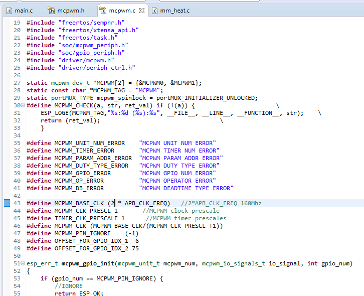

I need a complementary PWM with dead time generation of 150 kHz.
Here is a quality graph of the PWM Signal I need. Duty Cycle needs to be 50 % and frequency 150 kHz.
So I thought I use the MCPWM module for that, but I recognized that the maximum frequency is about 2 kHz.
When going higher the duty cycle is shrinking smaller and smaller.
At my desired frequency of 150 kHz the duty cycle is only about 10 %.
I guess the timer reaches its end or the bits are not enougth. Can I set up a timer with wider bits or crank up the timer frequency to be able to produce a higher motor pwm frequency?

My workaround at the moment is to change the prescaler of the mcpwm module directly in the idf driver folder:
However, this is not the best solution as the IDF should not be changed permanently because of updates etc.
But one suggestion: If the DEVs put in a #ifndef / #define a user could define the prescaler with the compiler or elsewhere to setup the frequency prescaler.

Any updates here? I'd like to achieve 40KHz on the S3. It doesn't look like I can get that with LEDC. Is MCPWM or RMT the answer?

Answering my own question for the records… RMT is (as it is so often) the answer.
