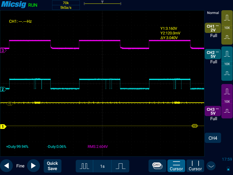

We found the same issue in another board as well. At the moment we do not have log print but from the oscilloscope we can see that the yellow line is TX from ESP32 and it is sending some garbage data.
I have seen in the code that there is reset for RX fifo but i don't see any reset for TX fifo in ESP IDF v3.1.
Could you please how to reset the TX fifo. I believe it is something not right in TX.
Thanks
Ganesh
Thanks
Ganesh

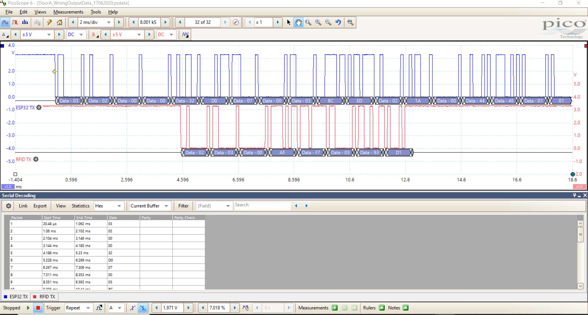

Hi there,
Can someone help me why the TX data is sending the wrong frame data.
After more debugging i found very wired data coming out from the esp32 Tx.
Correct data should be
but it sends out
It is just looping around the data.
I need to reset the TX fifo. Can anyone help me how to reset the TX fifo in esp idf 3.1
Thanks
Ganesh
"021a00444e010100130022030002000032e803000302000032d0070003bced"but it sends out
"0302000032d0070003bced021a00444e010100130022030002000032e80300"I need to reset the TX fifo. Can anyone help me how to reset the TX fifo in esp idf 3.1
Thanks
Ganesh
