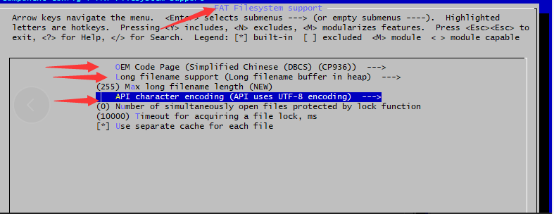

ADF版本 v2.0 IDF版本 v4.1
请问播放sd卡mp3 音乐的时候出现如下log是为什么?
I (368) SDCARD_MP3_CONTROL_EXAMPLE: [1.0] Initialize peripherals management
I (378) SDCARD_MP3_CONTROL_EXAMPLE: [1.1] Initialize and start peripherals
I (888) SDCARD_MP3_CONTROL_EXAMPLE: [1.2] Set up a sdcard playlist and scan sdcard music save to it
E (888) PLAYLIST_SDCARD: open file error, line: 112, have you mounted sdcard, set the long file name and UTF-8 encoding configuration ?

我也发现这个问题,一直找不到原因。现在买了一个esp32_Lyrat板运行这个例程,不会出来这个问题,但不会播放音乐,按play后,出现 [0;31mE (5527) FATFS_STREAM: Error, uri is not set[0m ,esp32复位了,
mnjhuy86
Posts: 26
Joined: Fri Jun 05, 2020 8:10 am
Re: 播放SD卡音乐问题
Postby mnjhuy86 » Thu Jun 11, 2020 12:37 pm
make menuconfig ,把选项改成这样就可以通过的。感谢宇空痕的指导

Postby smart123 » Fri Jun 12, 2020 12:21 pm
非常感谢!!!
