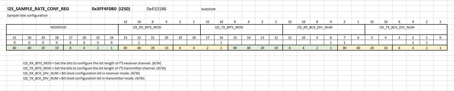

I included information about some ESP32 Registers used in this sample code.
ESP32 Estudos sobre I2S.xlsx
Excel Information about some ESP32 Registers
(21.02 KiB) Downloaded 1844 times
ESP32 I2S Sample rate config.JPG (123.23 KiB) Viewed 71044 times
Retired IBM Brasil

void bckI2S0config ()
  Serial.println();                                                                         // ESP32 Tech Reference page 308
  Serial.print("I2S0 sample rate configuration (0x");                                       // print register name and address (0x3FF4F0B0)
  Serial.print(I2S_SAMPLE_RATE_CONF_REG(0), HEX);                                           // Register I2S0 sample rate configuration
  Serial.print(") = 0x"); Serial.println (REG_READ(I2S_SAMPLE_RATE_CONF_REG(0)), HEX);      // print register value = 0x410186 (default)
  I2S0.sample_rate_conf.tx_bck_div_num = 4;                                                 // TX BCK clock = MCLK / num
  I2S0.sample_rate_conf.rx_bck_div_num = 4;                                                 // RX BCK clock = MCLK / num
  Serial.print(") = 0x"); Serial.print (REG_READ(I2S_SAMPLE_RATE_CONF_REG(0)), HEX);        // print register value = 0x410104
  Serial.println(" after configuration");
