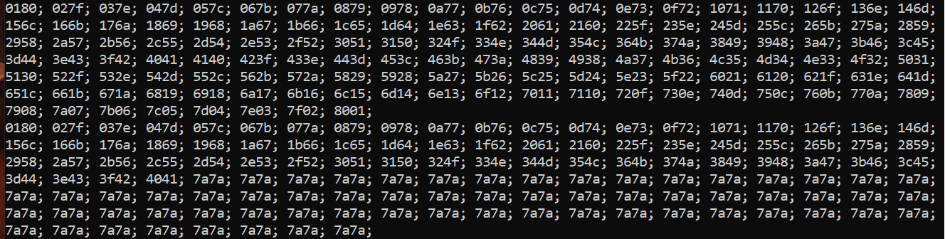

Hello friends, I'm an ESP32 newbie and I'm getting some doubts. Right now I'm trying to make my FPGA communicate with my ESP32 via SPI. The FPGA is working as the master and its working as intended, but sometimes the ESP32 doesnt read the whole message. The image attached shows the received messages. The first one with hex numbers from 0180 to 8001 is the correct message, the second ones is incomplete (7a7a comes from the memset I do every iteration of the code). Can anyone help me understand this? The master is workin on a 1MHz clock.

Im sending 128 16 bit numbers.

Without a detailed review:
I would not use the ESP as SPI slave. If you do then you must think clearly about latency. The 7a7a seems to indicate that you only received part of the message which then suggests that you only started the SPI slave transaction after the master had already started transmitting.
Handshaking with the ESP will take some effort. The ESP drivers will take 20uS+ setup for each transaction. I don't think that you have either dual or circular buffer DMA options & so you will always have down time between transactions. Add in interrupt latency EDIT: & blocking (100 uS by the book but I see >2mS on 4.1 beta when Ethernet enabled) and you get the picture. You can minimise latency with careful core planning but even so you do not have dual/circular DMA and so have an amount of software latency.
Instead I would be inclined to make the ESP master. Then the slower ESP can control the transaction. The other way around has to have extra delays as margin for error (if you think about it) so ESP master can be 'fastest' solution. Also typically the silicon is slave & an FPGA is silicon in my book.
EDIT: Send 1,2,3,4 etc from master to confirm that slave was not ready. Or a slow saw if the master is an ADC etc etc
& I also believe that IDF CAN should be fixed.

Try to add some extra bytes to the expected receiving value.
Let say you are assuming to get exactly 68*8 bits, then set the value to the 80*8.
You may still need to add some dummy bytes from the SPI Master side.
