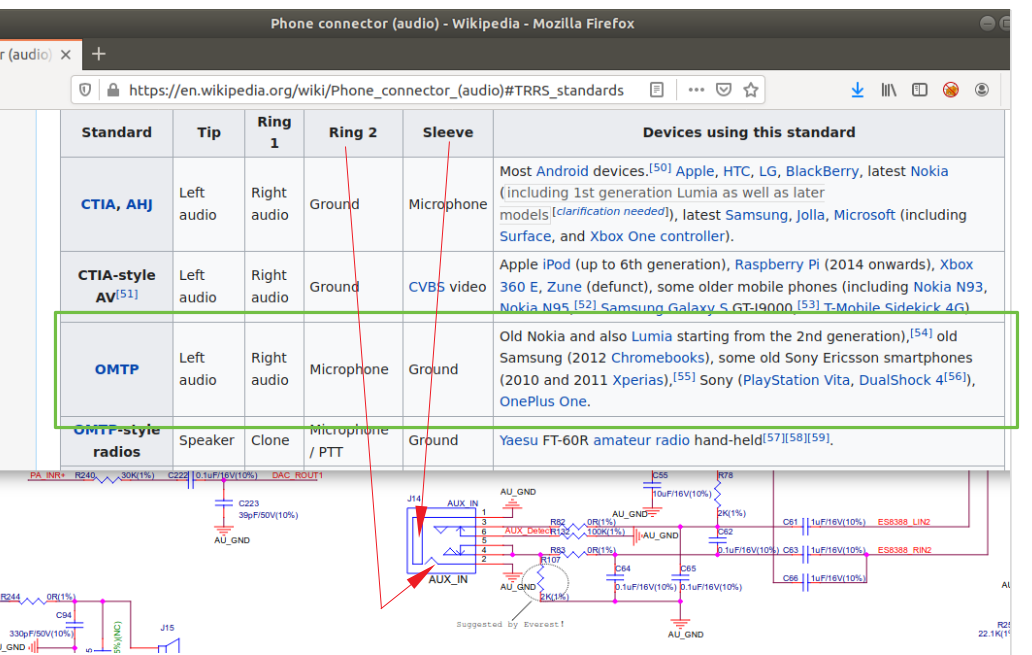

Hi, I have an ESP32-LyraT v4.3 board. I couldn't find out whether the AUX-IN jack is TRS or TRRS in the schematic or the website. Does anyone know?

The AUX_IN socket is TRRS with Ring 2 grounded. So effectively it is TRS.
