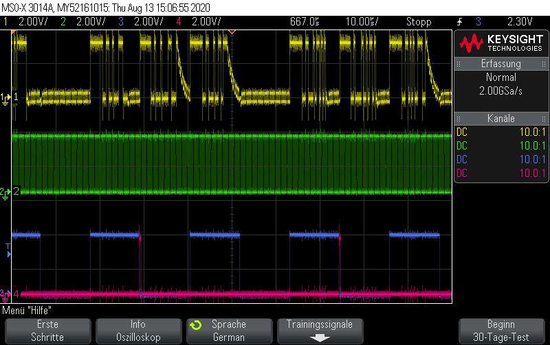

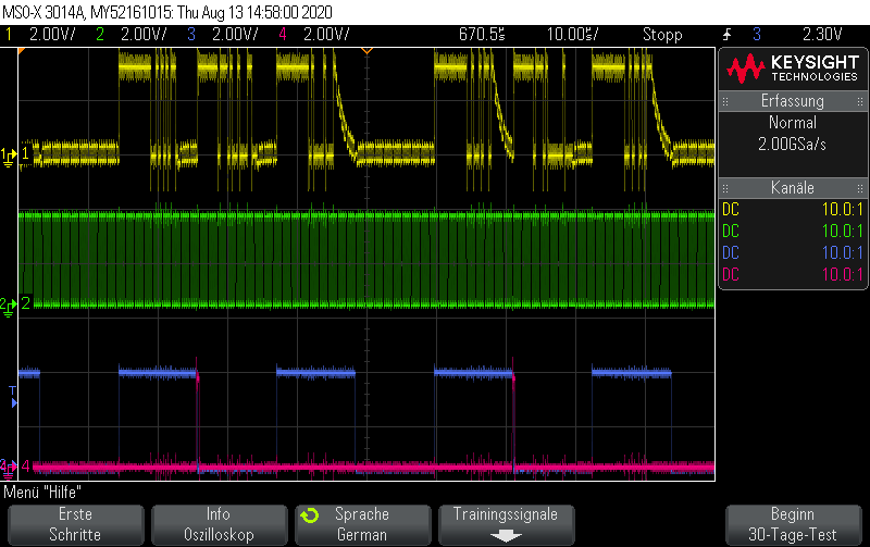

Oscilloscope measurments:
I2S_COMM_FORMAT_PCM_LONG:
I2S_COMM_FORMAT_I2S:
I2S_COMM_FORMAT_I2S
yellow: SD
green: BCK
blue: WS
pink: WSO of mic 1 to mic 2

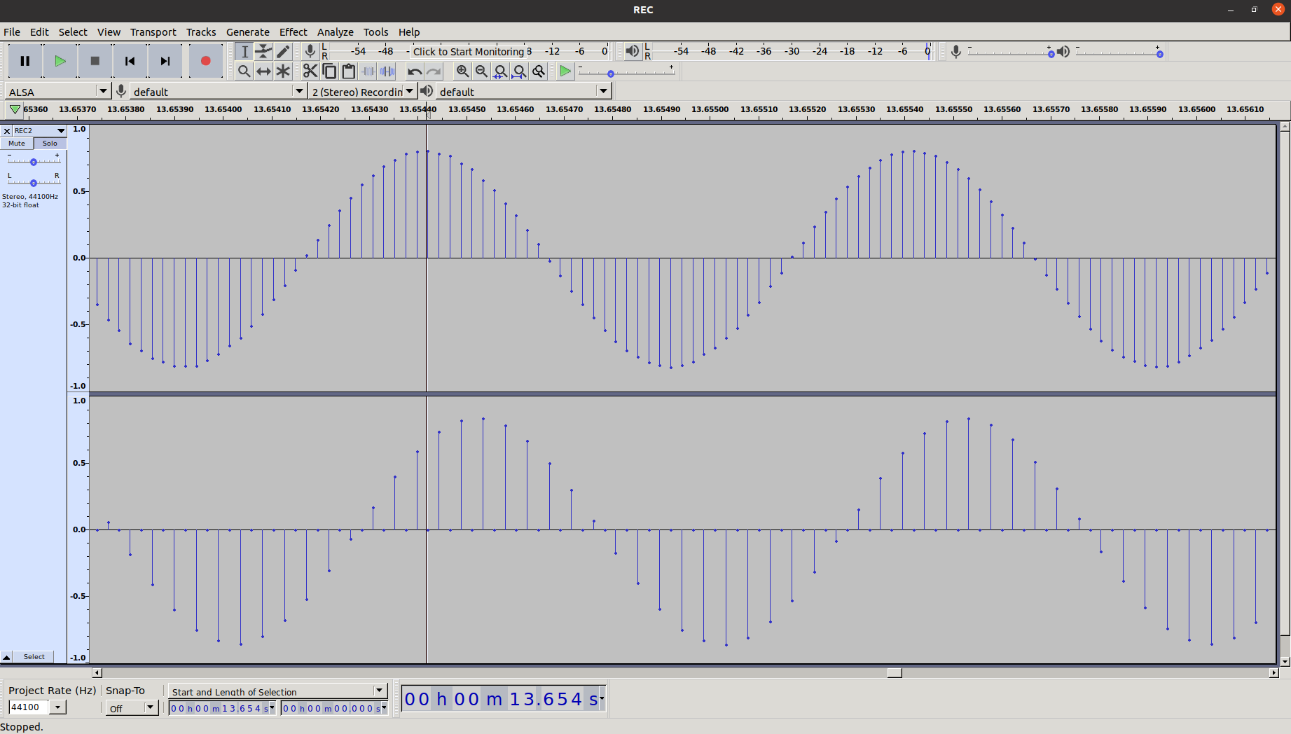

This leads to the effect, that every second sample of the second channel is
zero, since the second ICS52000 gets no WS signal evey second word frame.
I would appreaciate if someone could give me a hint how to properly set the PCM format or a pointer for further research on this topic.
