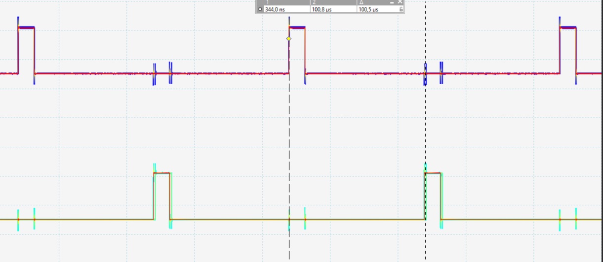

Third : When I test the mesh network and Core0 code seperately, i.e first run only mesh code and check that it works. Then run only the Core 0 code(Without mesh code) and check that it works, and yes it works as expected. As you see in the image below the digital outputs are fired precisely every 100us for a long time without large deviations. See image _ Core0_Tasks_No_mesh

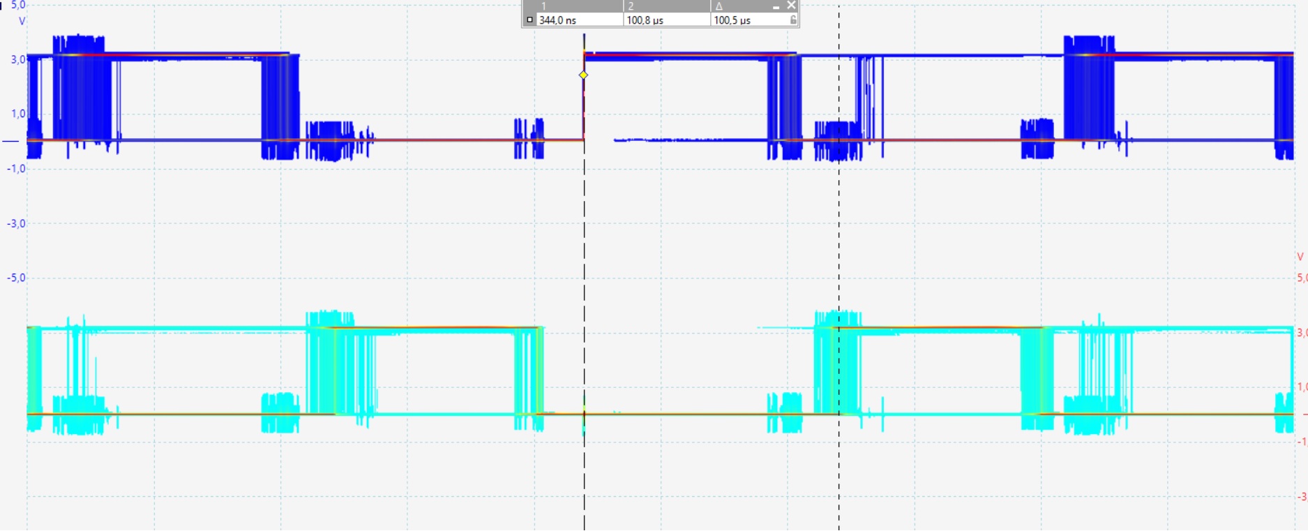

Fourth : When I put these two codes together then Core0 tasks are disturbed very much and I no longer observe the fine digital outputs firing anymore. It seems that the Core0 tasks are somehow disturbed by painlessmesh mesh network. See image _Core0_Tasks_With_Mesh. This is where I need help. I need to create precise digital outputs and also be able to communicate with other ESP32 via wifi mesh
1. What can be disturbing the Core0 tasks?
2. Could painless mesh be using the same timers as I am using and might this be the cause of the strange behavior.
3. Is it better to use esp_timer_create() to create timers instead of how I do above ?
4. Is there a way to know, if Core0 also runs other hidden tasks that I am not aware of. like for example, a task that is run by painlessmesh?
5. Should I change my approach to get this right? (Like better coding methods, or use other functions, like Semaphores instead of task notifications, or using EnterCritical() Macros while in interrupts etc?)
