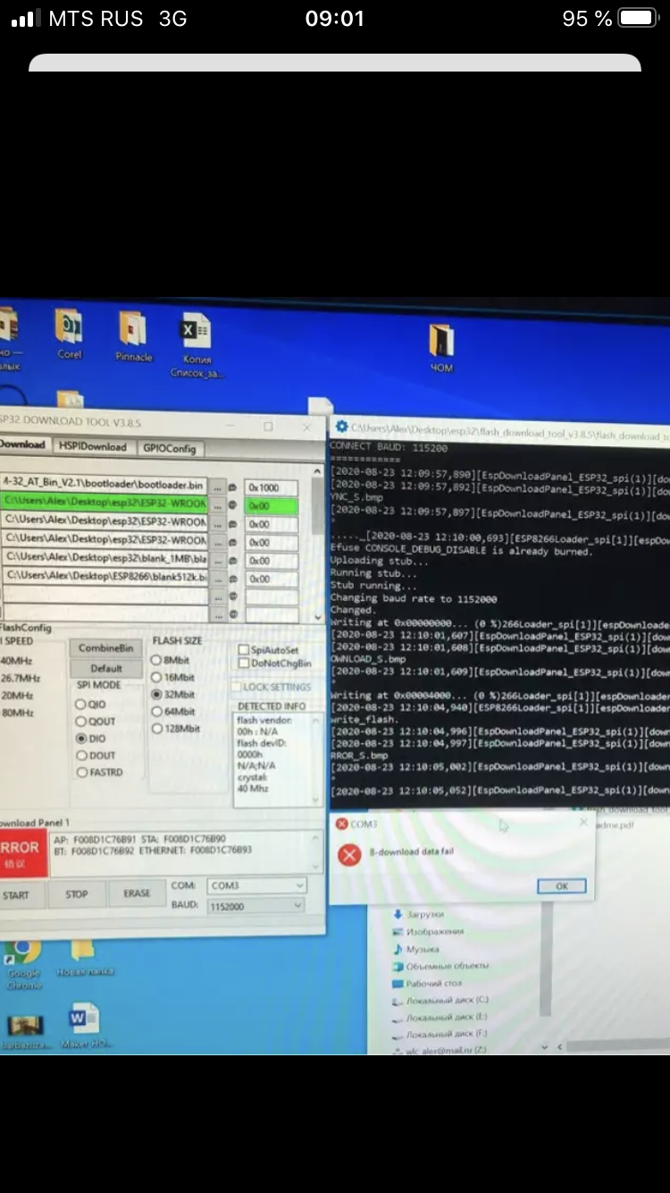

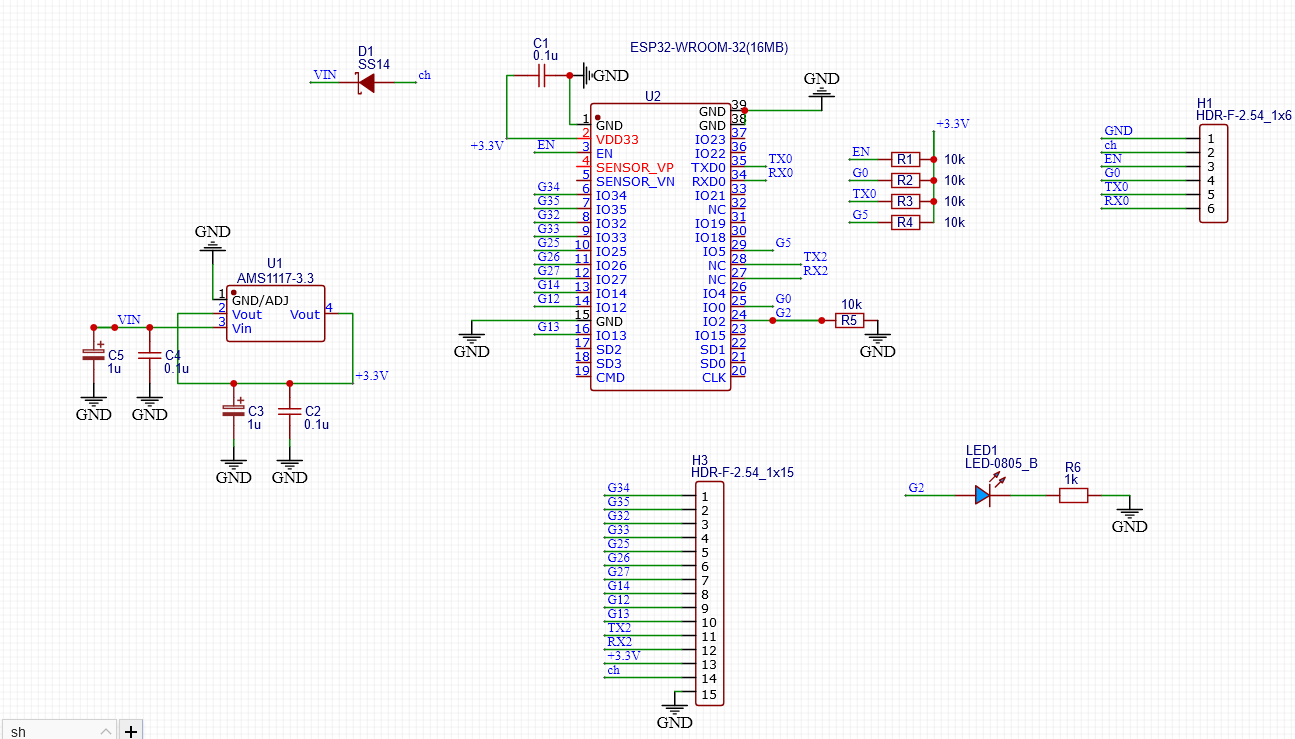

I have a problem with uploading to ESP32 module on custom pcb - any firmwares. Schematic is equal to devkit 1.

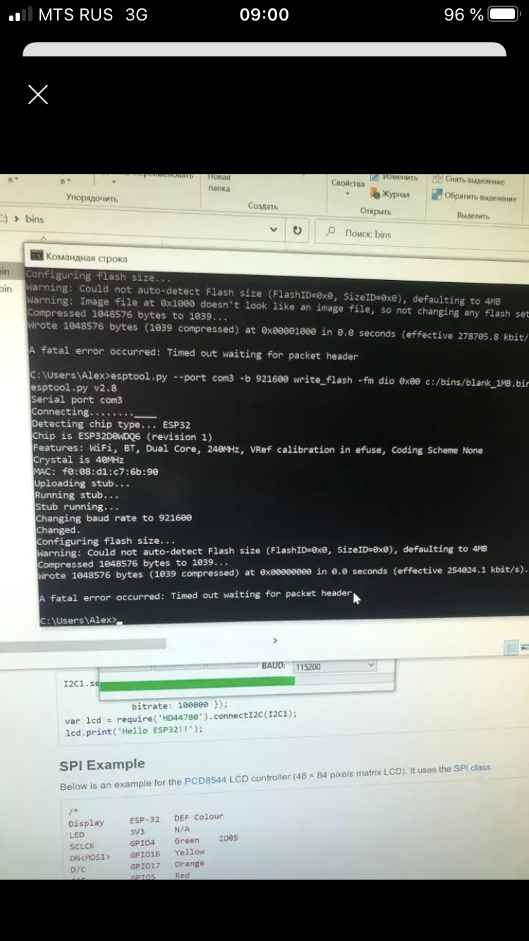

Module has a connection with all tools (esptool.py, flash_download_tool 3.8.5 and etc ) but stopping upload sketch/firmware everytime.
In attachments shematic and sreenshots..
