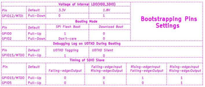

Hi rudy, ok, so let me see if I understand correctly.
GPIO0 and GPIO2 are strapping pins. GPIO0 needs to be high when flashing. And when R7 is not connected, it is driven high by the internal pull-up resistor. After booting it behaves like a generic push-button. Correct? Hmm, no, I still don't get it. Cause if so, then the only difference when R7 is connected is if the pull-up is done by internal or external resistor. I don't see why.
In the ESP-WROOM-32 datasheet, in the table describing the strapping pins it mentions "SPI Flash Boot" and "Download Boot", but I don't understand the difference between those two.

SPI Flash Boot = normal operation
Download Boot = firmware update from esptool

SPI Flash Boot means,In the ESP-WROOM-32 datasheet, in the table describing the strapping pins it mentions "SPI Flash Boot" and "Download Boot", but I don't understand the difference between those two.
esp32 is booting and read the Firmware from the connected SPI Flash
for this, the boot straping pins are for
GPIO0 1 (high)
GPIO2 don't care
Download Boot means,
esp32 is in "download" mode and waiting now for uploading the firmware
GPIO0 0 (low)
GPIO2 0 (low)
what you mean with flashing?
if you mean "boot from the spi flash" then is right
if you mean "upload your firmware" then is wrong
the other question i will let it open, perhabs you can now check by self
if not, write, so we see in it again
rudi
edit: WiFive was faster

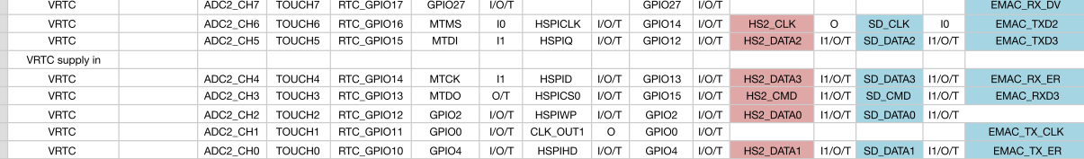

Re: Understanding non-connected resistors in reference schematic
edit: btw, you can allways pullup, pulldown the pinheader pins like you need.Also, with regards to the RTS and CTS pins. They are by default not connected, and thus have no purpose. If those are connected to GPIO13 and GPIO15...then what? When is that useful?
the example on gpio13, gpio15 is, if you want to use it as RTS, CTS
you can do it by connect GPIO13, GPIO15 on the pinheader.
that in the shematic there is no Resistor value, is, cause you can use this pins in variations of bootstrapping and using
cause this is what you want to do with it.
example:
if you want use it for the sd card driver
you pulled up
GPIO13 HS2_DATA3 / SD_DATA3
GPIO15 HS2_CMD / SD_CMD
if you want use it for example as GPIO input pins,
and want config the trigger ( ISR ) on a raise edge
then you can not pullup the pins, you mus pulldown
its like you want to use it, so you must config and solder it.
some pins are functionally
example then the pin GPIO15,
if you need this by set your timing too for SDIO
then you need to solder a switch for it on bootstrappmode.
after booting the switch give free your settings to your GPIO15 mode like you need or want ( pullup, pulldown )
hope this helps
rudi
