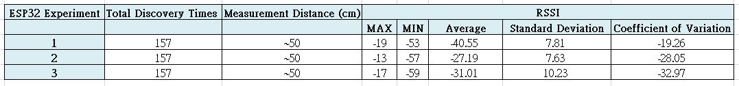

Hi Neil,
Actually, I didn't do too many experiments.
It's because the result seems very poor (compare to the result measured by my android phone), so I stop the further experiment.
You can check the statistical data in the attachment.
Totally I do 3 experiments for one target, each experiment performed 157 times scanning, the distance is about 50 cm.
Besides, I try to put the target and my EPS32 together (0 distance), but looks like the RSSI didn't change significantly.
Thanks
