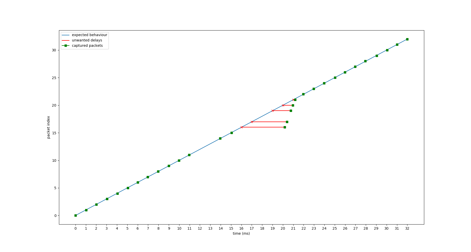

I am currently working on a project where an ESP32 based board is used in a legged robot as a bridge between a control computer using Ethernet or Wi-Fi and a set of sensors and actuators using SPI. The control loop is working at 1kHz.
While working in Wi-Fi, we are sometimes witnessing some sending delays, as if the ESP32 was queuing or holding the outgoing packets, not sending them immediately.
The following graph represents some Wireshark capture of the ESP to PC communication, where the ESP sends a message every 1ms.
X axis holds the timestamps of when each packet was captured, and Y axis is for the packet index (incremented after each sending instruction).
We should expect the plotted dots to almost lie on a straight line (the blue line for instance), whereas we clearly see that packets are sometimes way off, as if they were sent by the masterboard with a delay (represented by the red lines).
Any idea on how to avoid this buffering of the packets before sending them or what could be the cause?
Here is the Wi-Fi code we are using:

Thank you for your help,
Maxime

Hi maximekli,
We are facing similar problems, Did you ever find any solution or understanding for your problem?
Kind Regards
