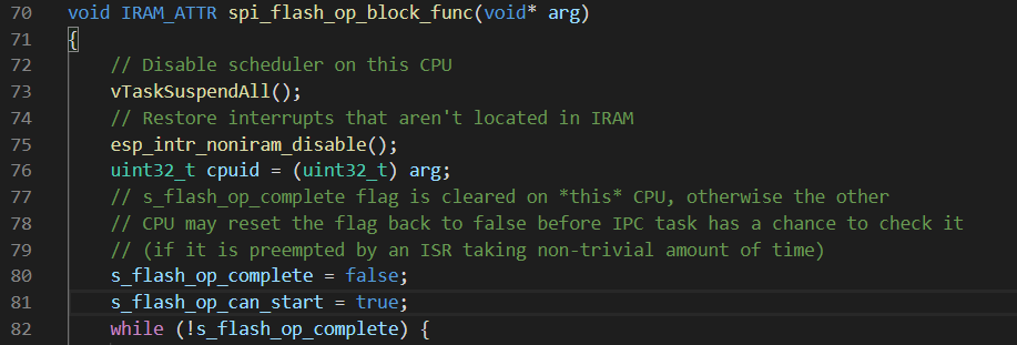

我根据 0x40088c65:spi_flash_op_block_func at C:/Users/DELL/Desktop/esp-idf/components/spi_flash/cache_utils.c:82这行信息,给s_flash_op_complete的定义添加DRAM_ATTR,运行了一下结果变成了IllegalInstruction,这个问题要怎么解决,有谁能指导一下吗?
谢谢!
cache_utils.c:82 (discriminator 1)
刚开始的log message
Guru Meditation Error: Core 0 panic'ed (Cache disabled but cached memory region accessed)

Interrupt every 2ms call

添加DRAM_ATTR后的log message
Core 0 register dump:
PC : 0x4008878a PS : 0x00060034 A0 : 0x80083044 A1 : 0x3ffbe2c0
0x4008878a: gpio_set_level at C:/Users/DELL/Desktop/esp-idf/components/driver/gpio.c:176 (discriminator 2)

Dazza0
Posts: 308
Joined: Fri Jun 02, 2017 6:50 am
Re: Error: Core 0 panic'ed (Cache disabled but cached memory region accessed)
Postby Dazza0 » Wed Sep 09, 2020 9:34 am
会不会是 stack overflow 呢?我看见 reg dump 里的地址有几个 0xBAD00BAD
Hydneman
Joined: Mon Aug 24, 2020 2:19 am
Postby Hydneman » Fri Sep 11, 2020 7:23 am
Yeah, I think maybe you cause the stack overflow, because 0xbad00bad is not used in our system map.
By the way, you should give us more detail about this issue, in order that we can make your issue recur, and solve your problem.
Thanks.
