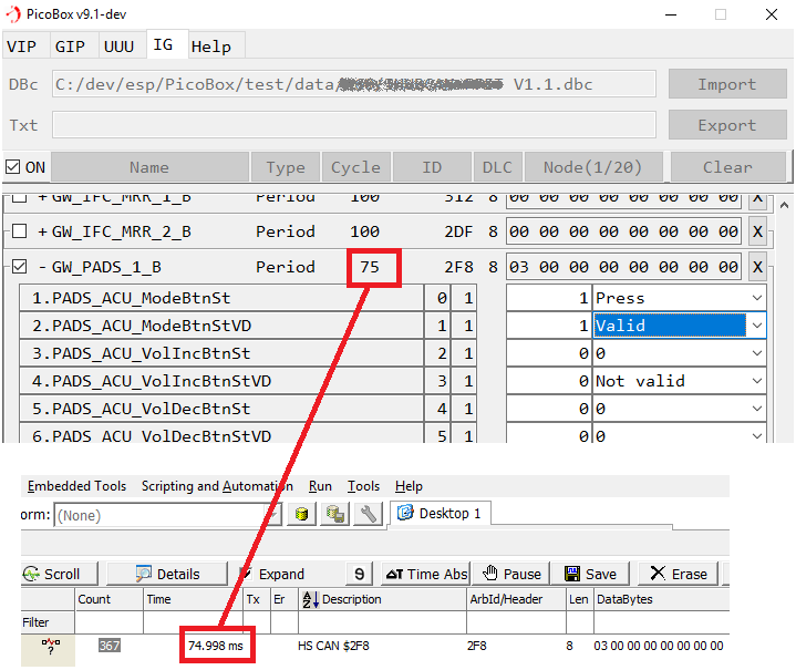

I've implemented ISO15765-2(CAN Transport Protocol) in ESP32, and ISO14229 UDS (Unified Diagnostic Services) on modbus to communicate with PC. It works well.
I also implemented an IG(Interactive Generator) function by ESP32 chip recently. The cycle accuracy suprised me: very close to CANoe IG: 0.00x ms
So ESP32 seems working well out of a car both on diagnostic and CAN simulator.

A snapshot about ESP32 CAN cycle accuracy.
