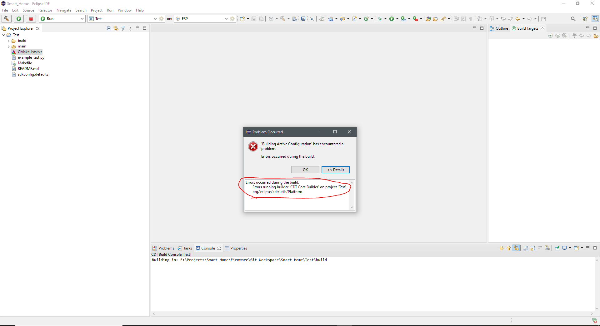

I am in the process to install and configure the ESP-IDF toolchain and libraries to develop the ESP32 microcontroller using the Wrover development board. I am using Xubuntu 18.04 and have done the following steps:
- Gone through all steps of the "Getting Started Guide" and installed ESP-IDF and toolchain
- Installed Eclipse CDT 2019.12 and the IDF Eclipse Plugin according to this guide
- Gone through the debugging installation instructions
- Finally configured GDB Hardware Debugging in Eclipse CDT according to these instructions
This was a long way and I was very happy first, since everything worked fine; from building to debugging and stepping through the code.
I cannot remember what I did next, but suddenly I got the following error in Eclipse CDT when trying to build one of the example projects (like the blink or hello-world examples):
The last thing I remember to have edited before I got this error were the following two lines in ~/.profile:
export IDF_PATH="/home/nicolas/Workspace/Eclipse/CDT/esp-idf"
. $IDF_PATH/export.sh
Any idea what my setup have might screwed up?
Let me know if you need more information to help me out. I am really looking forward to get my hands dirty with ESP-IDF, but it currently won't let me to do so...

I have installed the eclipse environment from scratch as per the procedure, created an example project from the template & compilation results exactly in the same error
"Errors occurred during the build.
Errors running builder 'CDT Core Builder' on project 'test'.
org/eclipse/cdt/utils/Platform"

Just started happening to me after an Eclipse update.
Tried reinstalling (everything :cry: ), and using a new workspace, but no joy except for the first build - and then fail after that.
Errors running builder 'CDT Core Builder' on project 'X'.
Builds fine from the command line.
Very frustrating!

Same problem here, after an eclipse update and an update of idf.
Is there a solution? I also tried to switch workplace, reinstalling plugin and tools but nothing helped

I switched back to previous version of eclipse (2020-06) & was able to compile.
