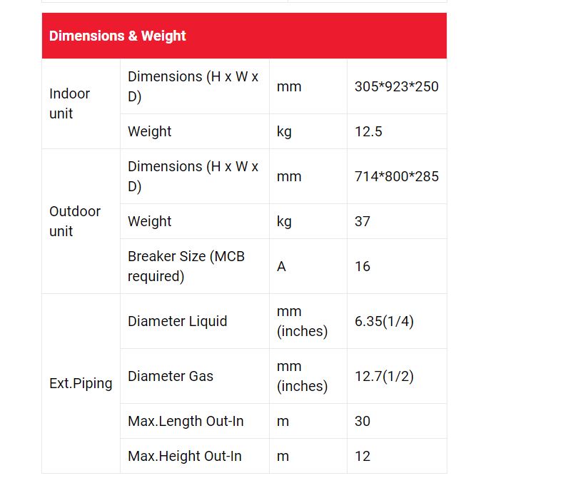

I have attached the details of Mitsubishi AC below:
- Modelno.jpg (78.75 KiB) Viewed 9617 times
- dimensions.jpg (52.73 KiB) Viewed 9617 times
- Capacity.jpg (67.53 KiB) Viewed 9617 times

As Sam has provided details with specification for Mitsubishi AC. Let us know if you need anything else from our end to move further for same.

...how do you expect me to debug a communication issue with a random airco if you give me the specs of it? If I tell you my laptop is a Thinkpad T470S, can you tell me why it crashes sometimes?
If any, please start with debugging this issue yourself instead of going 'doesn't work, let's head to the forums'. Can you confirm you get any output at all? Do you have a logic analyzer? Can you check the protocol of an existing remote control and see how it differs from the output values of your code?
