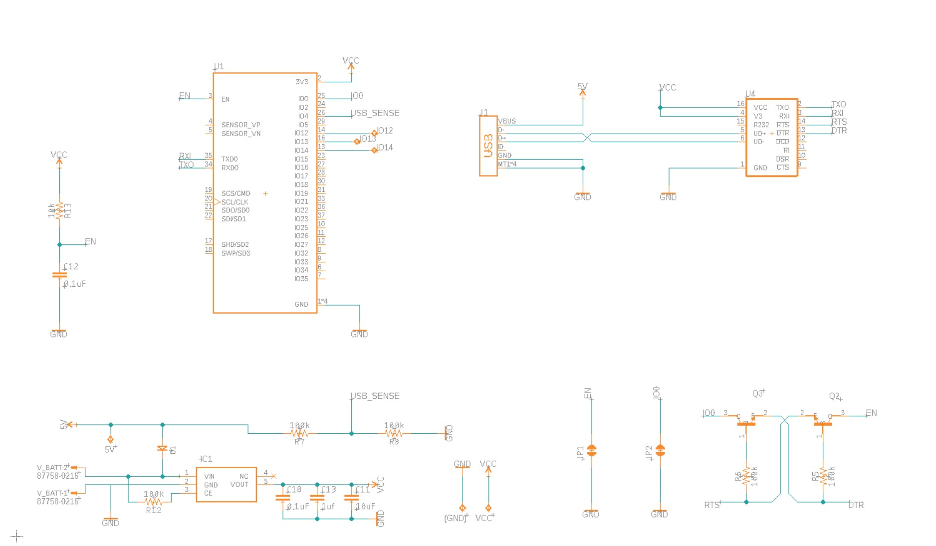

I've built a custom PCB designed to use the ESP32 WROOM. During the assembly and validation of the board I've been using example arduino programs to make sure the esp32 is running correctly.
Currently, I'm having a problem with running wifi examples on my board. When I flash the WiFiScan example, I get the following console output. Sometimes it will reboot and display the same messages a few times before it permanently hangs. Occasionally it will cause a kernel panic and crash my mac.

Here is my schematic. U1 is the ESP32-WROOM, U4 is a CH340C, and IC1 is a HT7833 LDO.
I am able to successfully run basic serial programs such as echoing serial console input, etc...
In searching the web before posting here, it was suggested to measure the logic levels of the bootstrapping pins...
GPIO 0: High
GPIO 2: Low
GPIO 4: High
GPIO 5: High
GPIO 12: Low
GPIO 15: High
At this point I’m really stumped. I would appreciate some help. Thank you.

What is IC1? Are you sure your setup can deliver at least 500mA on the 3.3V line?

And are you sure the LDO can get 500mA to the device at all times? For instance, if you feed the device using USB, are you sure the USB cable is nice and thick? Can you try feeding the 5V via a lab power supply instead and see if it still crashes?

You might need .1uF and 1uF closer to the ESP32 VDD supply. Can you share your PCB layout?
Wifi pulls a lot of current, it can cause brownout and the ESP32 will crash or reboot.
Try more output capacitance on your LDO, put a 22uF or 47uF.
You could also try a higher rated 3.3V supply for 600mA~1A

Thanks for all the suggestions. I found adding a 100uF electrolytic capacitor allows the system to work. I have some 600mA LDO's on order, which I am hopeful will allow me to remove the cap.
