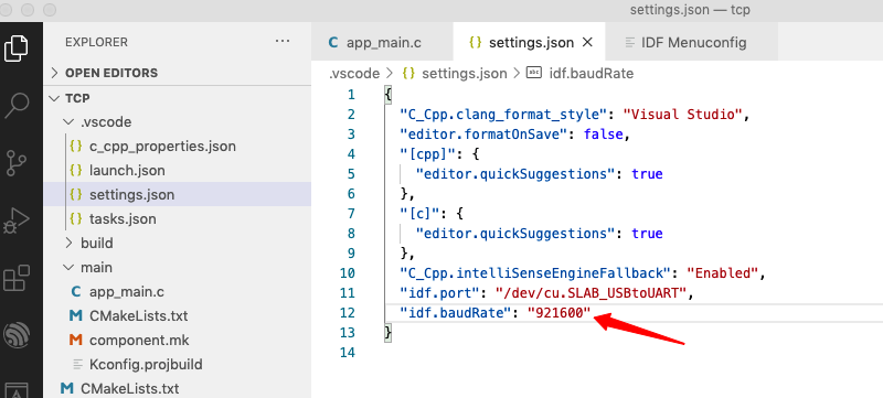

When flashing the device the default baud rate is 115200. I want to change it to 1152000.
I press F1 then select ESP-IDF- Device Configuration. From there i select Baud Rate, and enter in 1152000.
This does not change the upload rate, nor does it change the monitor baud rate to 1152000, so what does this setting do?

1152000 is not a standard baudrate; possibly your OS or serial driver doesn't like it. Perhaps try 1000000, as it's a bit more standard.

It looks like a bug. In the meantime I was able to change the rate by adding extra entry in "settings.json":

Thank you that worked. On the "official" ESP32 modules I have used 1152000 works. On others it's to fast.

This is a bug caused from vs code side due to certain behaviours change, we have a fix and will release this ASAP.
Thanks for reporting this bug, we have found the root cause and are working towards a fix, will also make this available ASAP.
Update: The baudrate bug is fixed and released in v0.5.0
