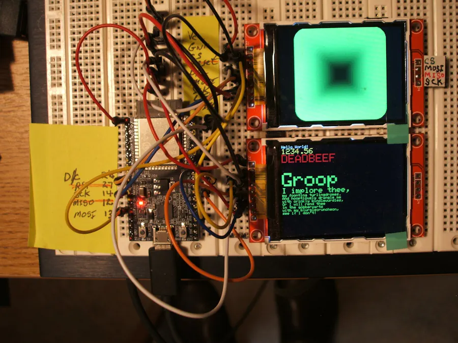

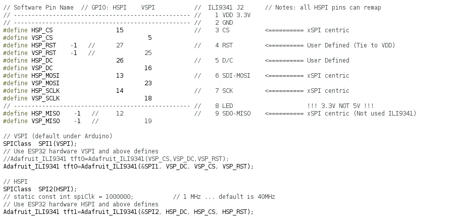

I have only gotten two to work fully previously: My example here is for ILI9341, HSPI & VSPI
Maybe you can use your approach to get 2 on each hardware SPI interfaces.
https://www.hackster.io/rayburne/dual-d ... p32-4c75b5
