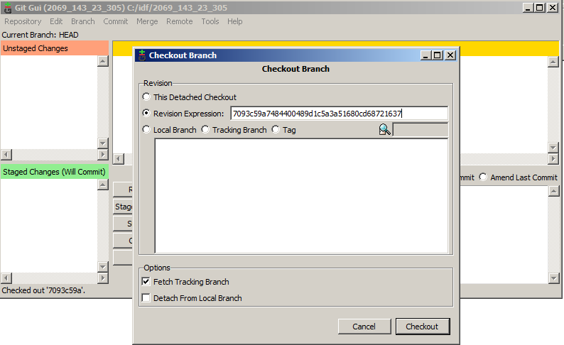

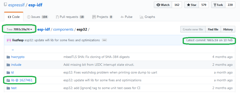

this is the last which ESP-AT Example runs without problems ( from my saved desk ) :
$ git submodule status components/esp32/lib
1627461bf2fc2ec8a090b30cddae2118d542c454 components/esp32/lib (1627461)
$ git submodule status components/bt/lib
9c1eea6bb03adc3b3847fff79c3f017652840a46 components/bt/lib (9c1eea6)
edit:
now i searched the things for you:
this is the ESP-IDF that is used for ESP-AT example:
https://github.com/espressif/esp-idf/tr ... ents/esp32
for using this as the actually ESP-IDF
i check out the things easy way with this:
all after this ( newer versions ) , the guru comes.
