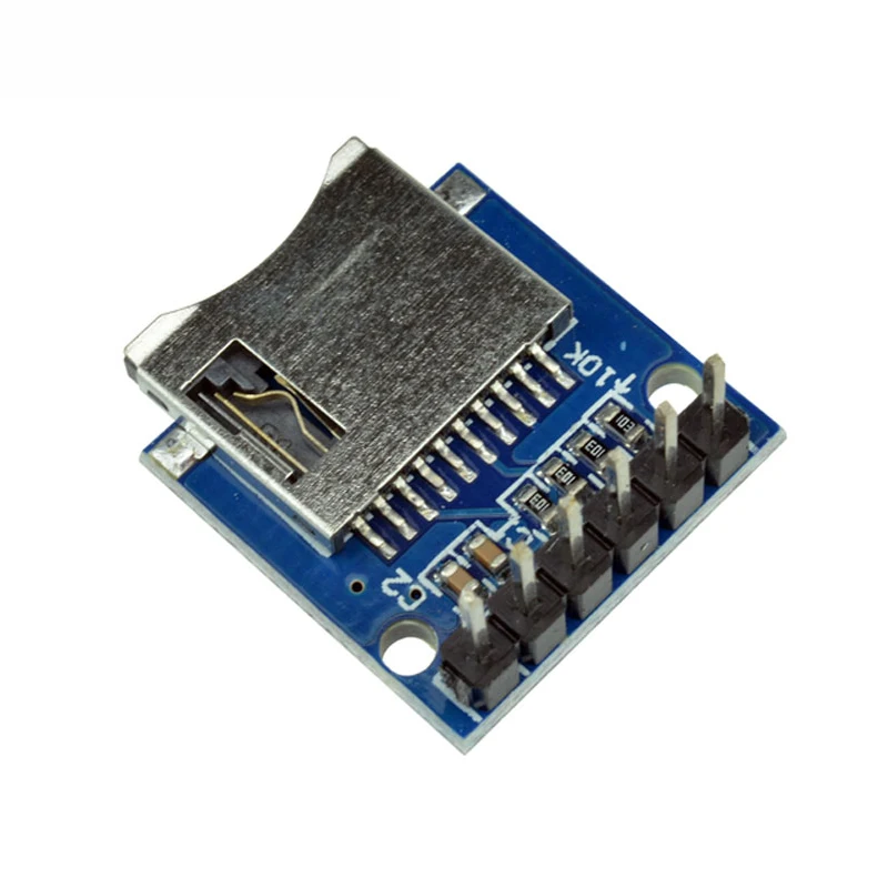

Hi guys! Please help if any chanse... I have stuck with the strange problem...
I am prototyping an simple board based on TTGO esp32 board... OLED had started instantly. But SD card inited, correct detected, returns right size and free space... but there is no chans to open for reading or writing file with the simplest name "1"... or any other name...
SD adapter - the most simple one (4 resistors to the 3.3V and two capasitors), Voltage 3.31V.

I have changed sd card adapter from this one with no regulator and buffers:
to that one with reculater and buffer:
Additionaly I tried to shortcut AMS1117, due to low voltage after regulator (2.6V)...
No effect... It seems the problem is in the software but no in the hardware...

If you are using second adapter, with regulator, you have to connect VCC to 5V on that adapter.
