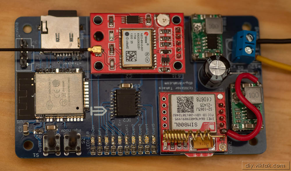

I have built a GPS tracker based on the ESP32.
The circuit is powered from a 12V car battery.
I use a buck converter to produce 4V for the GSM modem. I use another buck converter to provide 5V for the rest of the circuit. I use an LM117-3.3 to provide 3.3V for the ESP32 and the GPS module.
All works perfectly on breadboard. However, when I built a custom PCB of it, the ESP32 keeps resetting every time the GSM modem tries to connect to the GSM network.
This is the layout of the PCB:
This is the log from the ESP32:

The code running on the ESP32 is not relevant as the problem happens even if I upload an empty loop.
I hope somebody has some relevant experience and could help me out here, because I am in a dead end....
Thank you for any pointers in advance!

That looks like a power supply issue... a GSM modem can use lots of power for a little while while communicating with the network, and if the impedance to your power supply is too high, it can drop the power supply line to a level that's so low that the ESP32 reboots. You should be able to catch that by putting a scope on the 3.3V line.

That's what I thought too at the beginning, because it took me a while to decide on the power supply for the thing on the breadboard.
I checked it with the scope and I can't see any dip on the 3.3V line.
Since then I have been experimenting with it and now I found that if I remove the DC-DC converter (for the modem) from the PCB but still use the same one to power the modem (using small wires) then the issue is gone.
This leads me to believe it is some (high frequency) noise the converter generates that messes up the ESP. Or a combination of both...
Now I'm going to try to shield the converter from the rest of the circuit with some aluminum foil and see what happens. Or is there a "standard"/proper way of doing the same?

ESP32 + modul GSM SIM800L reset reboot. Hi, this problem has been bothering me for quite some time. I think there are two issues.
- It is absolutely necessary to connect a large capacitor of at least 2000uF directly to the SIM800L pins, along with a 100nF ceramic capacitor in parallel.
- And be careful: resets are also caused by interference from the SIM800L when logging into the BTS and then again when establishing a connection with the BTS at the beginning or end of a call. It’s clear that the design of these PCBs has a critical flaw. An example is the small ESP32 C3 board with or without an OLED. This board resets every time the SIM800L starts up. I emphasize that the SIM800L is not connected in any way to the ESP32 C3 circuitry during this test. The cause is therefore clearly the induction of RF energy into the ESP32 circuitry. The ESP displays error code 9.
Some boards are more susceptible, others less so. I have tested both ESP32 C3 boards with and without OLED displays, and they are unusable for this combination. In addition, the Wi-Fi antenna circuitry is very poorly designed. A connection to a cell phone is only reliably established within a few meters. I estimate that the ESP32 C3 antenna’s performance is about 20 dB worse than that of a standard cell phone.
By the way, all the ESP32 modules I’ve tested have this flaw—a very weak integrated antenna. Some more so, some less so.
If anyone has encountered the reset issue with the ESP32 + SIM800L combination and has managed to resolve it, I’d appreciate it if they could let me know. I’m interested in smaller models. I found a rugged ESP model—the HELTEC Wi-Fi Kit 32—but it’s large and has high power consumption, which isn’t suitable for battery operation. Thanks, mpczmpcz, Aug 2, 2026

As previously mentioned, a capacitor across the 3.3V and GND (I'd recommend 470uf, but 2000UF would probably work too). Would we be able to see a copy of your source code?

I am also thinking of the GSM signal itself, which can be quite powerful, especially if the tower is not nearby. It might be strong enough to induce a current in a part of your circuit that disturbs the ESP32. Or the on the ESP32 module itself. That would also explain why it happens when the modem has connected to the power.
If the power drops, I'd expect a "brownout" or "power loss" as boot cause, not a watchdog timeout.
