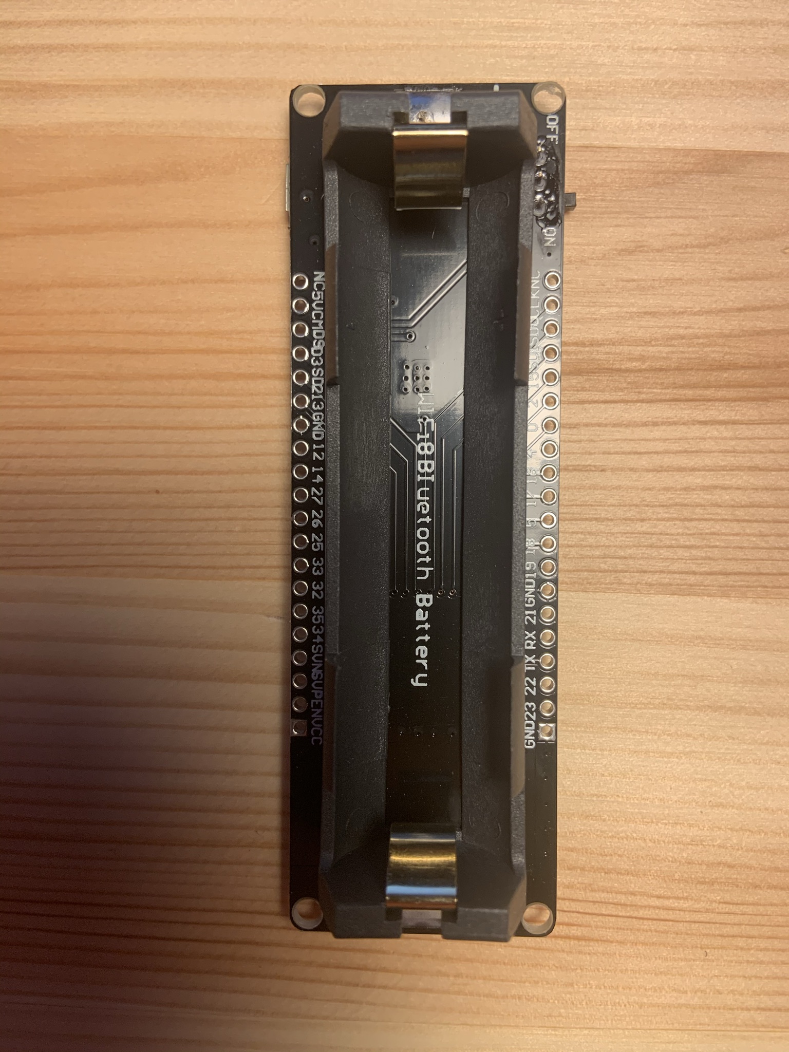

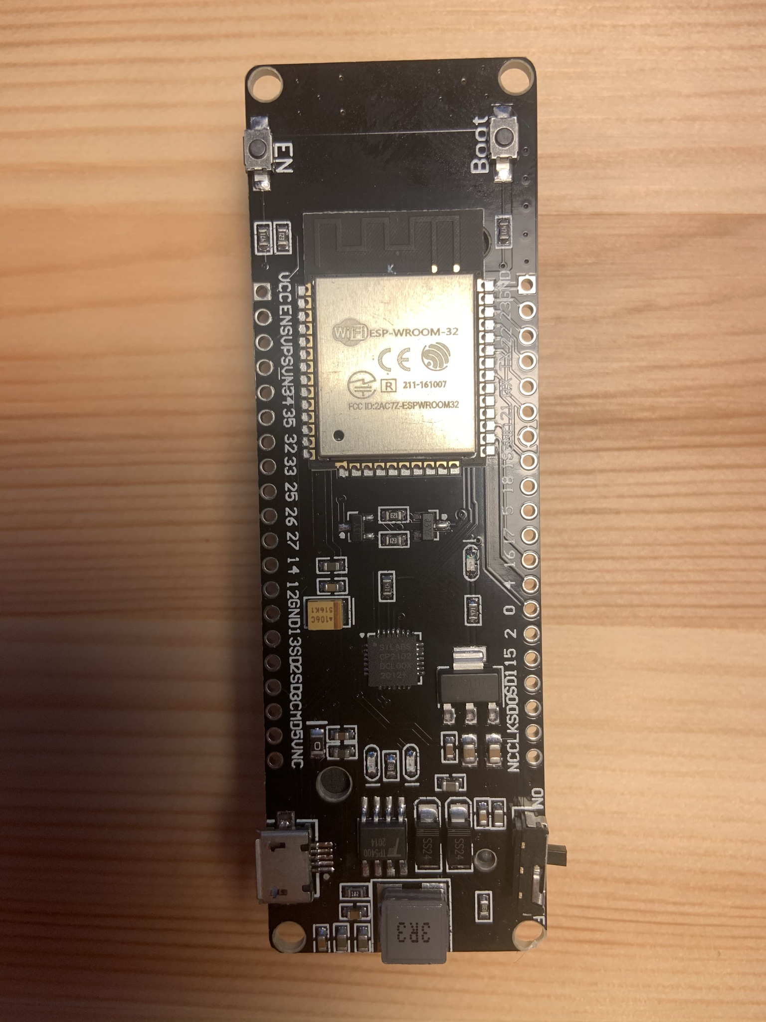

Hey guys,
I recently bought an ESP-WROOM-32 module that sits on a developer board that can also hold a battery (see pictures and this https://www.aliexpress.com/item/3304624 ... 4c4dIUX6jB)

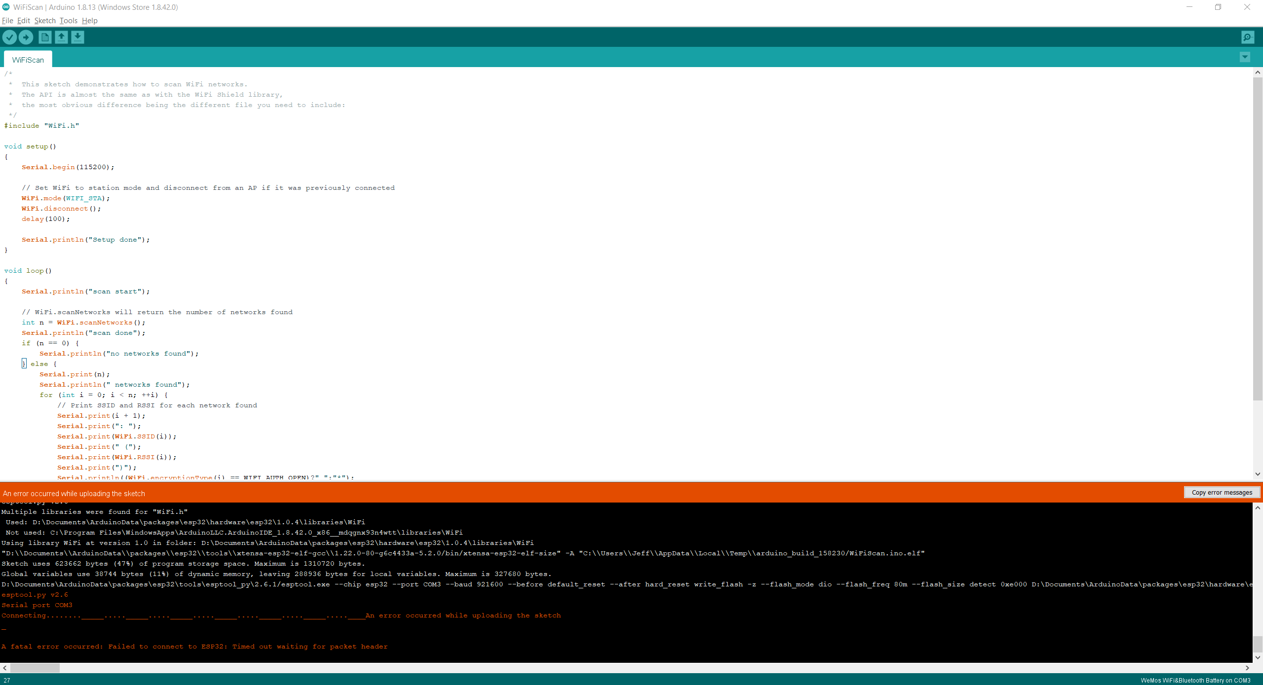

I've downloaded and installed Arduino IDE in order to upload code to the device.
I use the following settings:
  • Board: Wemos WiFi&Bluetooth Battery
  • Upload speed: 921600
  • Port: COM3
After clicking on 'Upload', the following error message shows up after a while: 'A fatal error occurred: Failed to connect to ESP32: Timed out waiting for packet header'

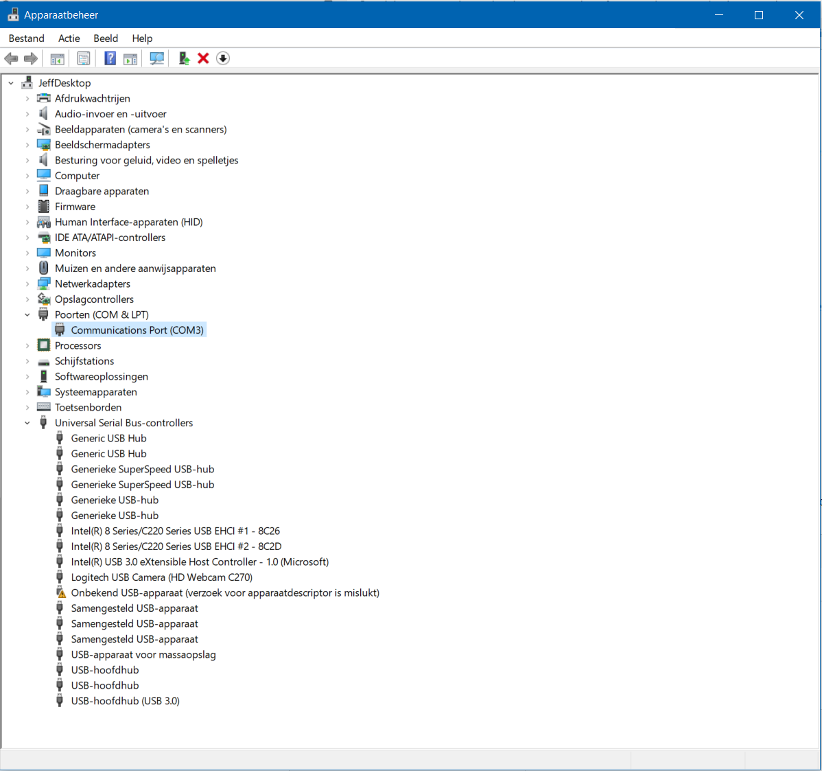

  • I've checked in device manager and there it shows: 'Unknown USB Device (Device Descriptor Request Failed)' I tried to delete the device from the list, restart the computer, make it install again but with no success.
Screenshot Arduino IDE.PNG (105.55 KiB) Viewed 8111 times

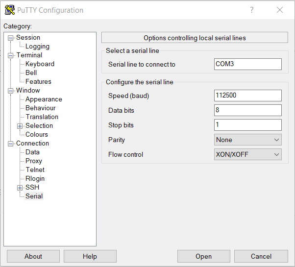

I'm uploading a picture of the settings and what I see in my device manager (in Dutch). I tried to install the driver first from this website : https://www.silabs.com/products/develop ... cp-drivers
I downloaded putty and tried to connect to COM3 at the proposed baud rate but nothing happens when I click on 'Open'. Screenshot of PuTTy attached.

I might think that the bad rate should be 115,200 rather than 112,500. I believe that difference would would take it out of the 3% timing error RS232 use to allow on slow data lines before the advent of good timing chips. Does a scope show activity on the chip TX pin even if your PC does not?

Maar goed dat ik ook Nederlands ben :P You seem to have at least one USB device that Windows can't recognize ('onbekend apparaat'). Does that go away if you unplug the devboard? If so, something between the USB-to-serial converter on your devboard and your PC is broken.

@ESP_Sprite, Altijd handig als je Nederlands spreekt ;) I've continued troubleshooting and found the following things:
- Unknown device goes away if I unplug it.
- Unknown device shows up even if I used another USB cable
- Unknown device shows up even if I use another USB port
- Unknown device shows up even if I use another ESP development board
- Unknown device shows up even if I use another computer
Also tried a third USB cable but then nothing at all shows up. Maybe that cable does not have a data wire?

That is strange... If any, the 'unknown device' is because communications between the USB port and the CP2102 is not OK, and it's something very basic (like e.g. the USB D- pin not making a connection or the CP2102 not receiving power or something).
A thought: it's hard to say without the schematics, but maybe these boards *require* a battery to be installed to power the CP2102?
