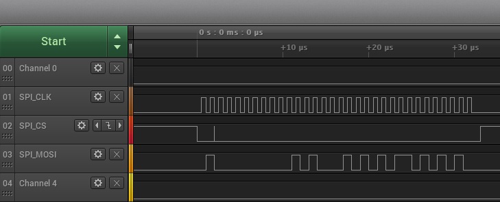

I am working with SPI interface in master mode
This is my peripheral configuration
#define PIN_NUM_MISO 19
#define PIN_NUM_MOSI 23
#define PIN_NUM_CLK  18
#define PIN_NUM_CS   5
  spi_bus_config_t buscfg={
      .miso_io_num=PIN_NUM_MISO,
      .mosi_io_num=PIN_NUM_MOSI,
      .sclk_io_num=PIN_NUM_CLK,
      .quadwp_io_num=-1,
      .quadhd_io_num=-1
  spi_device_interface_config_t devcfg={
    .clock_speed_hz = 10*100*1000,           //Clock out at 1 MHz
    .mode           = 0,                     //SPI mode 0
    .spics_io_num   = PIN_NUM_CS,            //CS pin
    .queue_size     = 3,                     //We want to be able to queue 7 transactions at a time
    .pre_cb         = 0,
    //Initialize the SPI bus
  ret=spi_bus_initialize(VSPI_HOST, &buscfg, 0);
  assert(ret==ESP_OK);
  ret=spi_bus_add_device(VSPI_HOST, &devcfg, &mcp23x17.spi);
My application transmit only four bytes periodically to slave device (device_addr+reg_addr+reg_data+reg_data)
  // wirte out
  memset (&t, 0, sizeof(t)) ;
  t.tx_data[0] = (MCP23x17_ADDRESS << 1) + 0x00 ;
  t.tx_data[1] = MCP23x17_OLATA ;
  t.tx_data[2] = outA ;
  t.tx_data[3] = outB ;
  t.flags      = SPI_TRANS_USE_TXDATA ;
  t.length     = 8*(1+1+1+1) ;
  ret = spi_device_transmit(mcp23x17.spi, &t);  //Transmit!
  assert(ret==ESP_OK);            //Should have had no issues.

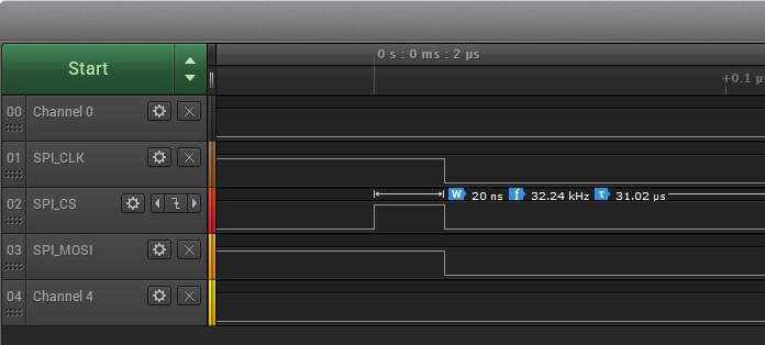

I check my code with EPS32 devboard without any device connected to SPI pins I have connect only the analyzer probes for checking the message format and sometimes I see a little glitch in a random postion in the SPI_CS pin (I attach two images) The glitch is 20ns wide. When the SPI slave peripheral detect a CS change state reset the communication in progress and tx message fail. I dont know if there are more wide glitch on SPI_CS but I am worried.
My salve peripheral (disconnected at the moment) is an I/O expander MCP23S17 and datasheet say min CS hold time 50ns I think the 20ns glitch can't be detect but if sometime the glitch is more wide...
zoom on previous image

Hi accacca,
Have you ever managed to solve this problem?
I've experienced the same issue with 20ns glitches on CS pin.
It happened after esp-idf upgrade from v3.2.2 to 4.1.

Re: SPI CS glitch
Postby Sprite » Wed Oct 21, 2020 2:34 pm
20ns sounds pretty small... are you sure the glitch is generated by the ESP32, and isn't something that is inducted to that line? Putting a scope instead of a LA on there may tell.
