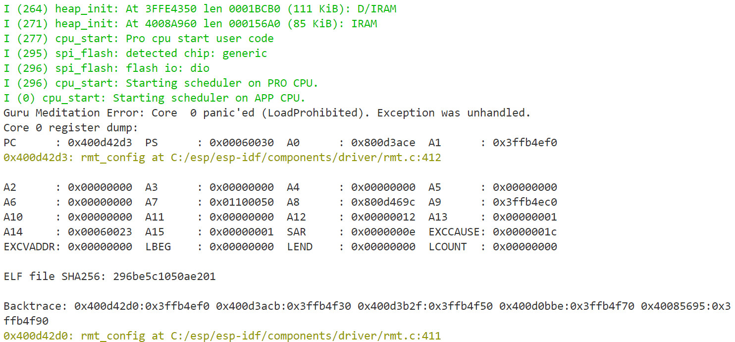

I am learning to use the RMT module to create a coded pulse stream.
The code was based on a post that was based on Kolban's ESP32 book and is copied below.
When I attempt to run the code, the processor continually resets.
rmt error.jpg (325.82 KiB) Viewed 3375 times

You declare ..
rmt_item32_t items[1];
.. then set two elements of a 1 element array ..
items[0].level1 = 0;
  items[1].duration0 = 0;
Standard C bug - array overflow.

Thanks
Shame the compiler does not flag the error
