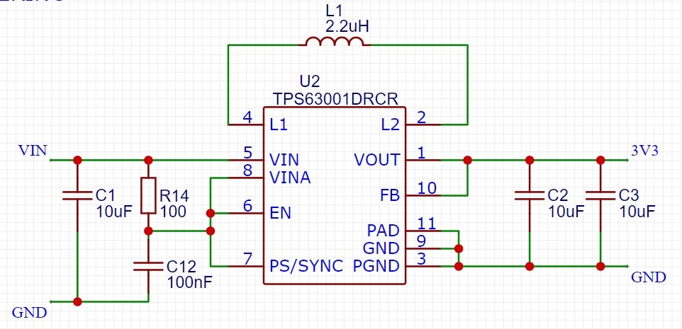

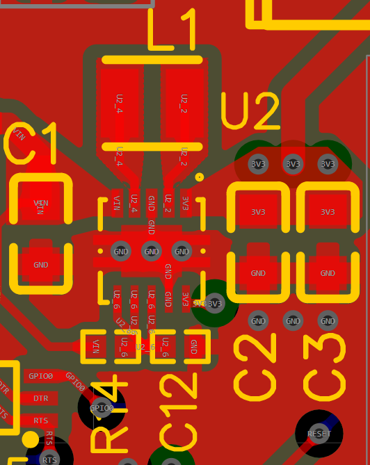

You could use a buck-boost to output a more reliable 3.3V from a single cell. I've had success with TI TPS63001
https://lcsc.com/product-detail/DC-DC-C ... 28060.html
