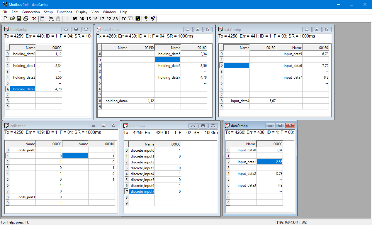

I completed the tests and the TCP slave is able to define several areas mapped to Modbus registers per each register space.
The definition of modbus areas is performed as in code below:
#define HOLD_OFFSET(field) ((uint16_t)(offsetof(holding_reg_params_t, field) >> 1))
#define INPUT_OFFSET(field) ((uint16_t)(offsetof(input_reg_params_t, field) >> 1))
#define MB_REG_DISCRETE_INPUT_START         (0x0000)
#define MB_REG_COILS_START                  (0x0000)
#define MB_REG_INPUT_START_AREA0            (INPUT_OFFSET(input_data0)) // register offset input area 0
#define MB_REG_INPUT_START_AREA1            (INPUT_OFFSET(input_data4)) // register offset input area 1
#define MB_REG_HOLDING_START_AREA0          (HOLD_OFFSET(holding_data0))
#define MB_REG_HOLDING_START_AREA1          (HOLD_OFFSET(holding_data4))
    reg_area.type = MB_PARAM_HOLDING; // Set type of register area
    reg_area.start_offset = MB_REG_HOLDING_START_AREA0; // Offset of register area in Modbus protocol
    reg_area.address = (void*)&holding_reg_params.holding_data0; // Set pointer to storage instance
    reg_area.size = sizeof(float) << 2; // Set the size of register storage instance
    ESP_ERROR_CHECK(mbc_slave_set_descriptor(reg_area));
    reg_area.start_offset = MB_REG_HOLDING_START_AREA1; // Offset of register area in Modbus protocol
    reg_area.address = (void*)&holding_reg_params.holding_data4; // Set pointer to storage instance
I define two descriptors for area (holding registers 40000 -40008 = holding_data0 - 3), 40158 - 40166(holding_data4 - 7)) to read four float values. The same is for input registers (input registers 30000 -30008 = input_data0 - 3), (input registers 30158 -30166 = input_data4 - 8).
The above is already changed in the attached example which also overrides parameter definitions and modbus component.
You need to unpack the archive to any folder in your computer with installed esp-idf the build and flash (idf.py -b 921600 flash monitor). This is part of official update in ESP-IDF per your feature request.
Please check the project and let me know if you have any issues.

Modbus_poll project to test

Thanks for the update. Now it works perfectly and I can define several areas of holding registers. But I have some general problems using this library (Modbus TCP-slave):
