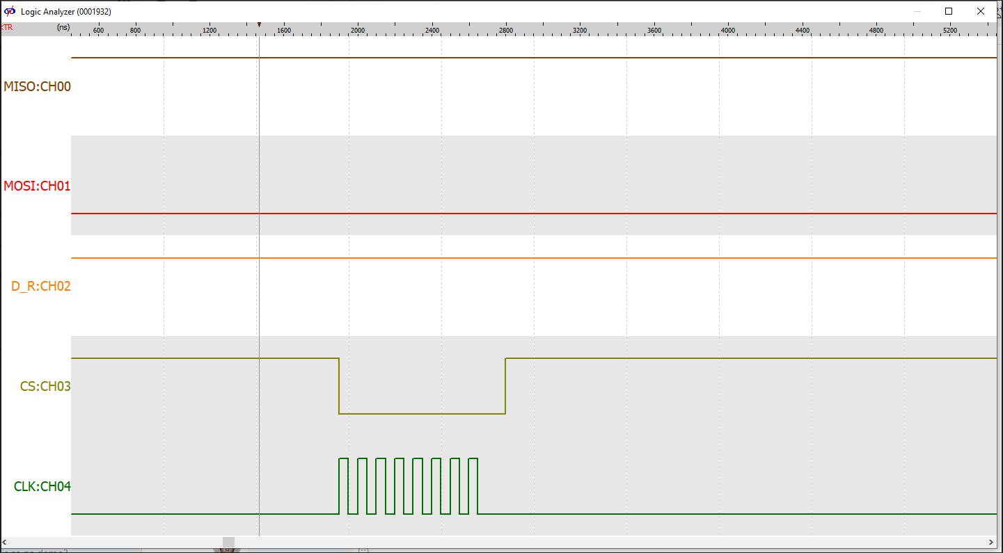

I am trying to connect ESP32 with ADC1120 over SPI. But without success so far.
When I probe the SCLK pin with an oscilloscope I can see there is not any clock signal.
I am using a GPIO matrix to route the signals.
I have 5 LEDs on board so I use them as debug signals for stepping.
at the end of the code, all 5 LEDs are ON so that means SPI init and device registration pass without any problem.
Thanks for any advice

It looks like you have initialized everything, but not sent any transfer over SPI. The clock signal will only be present during the transfer. Try to spi read or write to the adc and probe sclk during that time.

yes :) you are right :) I have added some code ( copy-paste from LCD example)

I can see the clock signal :) but not aby data are sent to ADC. MOSI has not changed :/
Maybe I have to solve the data ready signal first.
Thanks a lot

hmm, data ready pin is normally at high level .. no that is ok ... but no outgoing data on data lines :/

I wrote a small program which has to test the MOSI(IO13 pin in my case) pin and I can see there is not ticking on IO13

Check if your GPIO library refers to the physical pin numbers or the IO numbers, that's always something that can be mixed up. (If you were telling it to toggle physical pin 13 and you're probing on IO13, they're different pins).
Maybe search for some other SPI examples, see if you can get MOSI to work maybe with a different approach or different GPIO library.

you are right with the idea about the issue with pin mapping :)
I changed IO13 to another pin and now it WORKS perfectly :)
THANKS a lot
