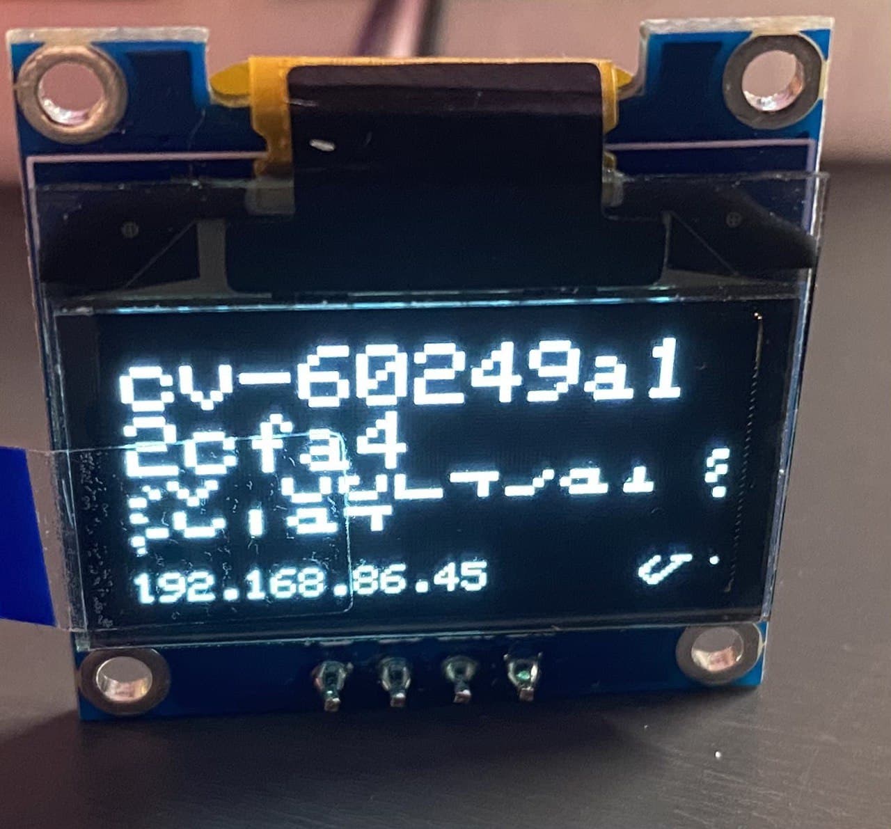

I'm currently working on a small project where I use an ESP32 as a webserver and have a SSD1306 OLED display attached to it using the Adafruit SSD1306 library (via platform io).
The screen is supposed to show some information, like the device's name, the IP and a little icon indicating if a client has connected to the websocket (hence the webserver)
the initial screen looks fine, it shows the information as expected. But when I connect to the ESP websocket and the "onWsEvent" is fired the screen needs to be updated. It does update but it looks just quite a bit off:

two things are to mention in particular here:
1st - a callback method is called that continues in my main.cpp and changes the display information
2nd - I added an output that shows the task name
And the output shows what I expected: All correct changes are made within the loopTask, when it is changed from the async_tcp task, it shows the problems as seen in the image.
I also have the same output in my method to change the display. here's the output:
WebSocket client #1 connected from 192.168.86.35
Core ID: 1
Task Name: async_tcp <- from onWsEvent
Core ID: 1
Task Name: async_tcp <- from display method because of the connect ws event
WebSocket client #1 disconnected
Core ID: 1
Task Name: async_tcp <- from display method because of the disconnect ws event
Core ID: 1
Task Name: loopTask <- from display method because i updated the screen from a serial monitor input
I am not very experienced with C++ and what's going on in the background in memory etc. i have only some basic understanding from my vocational training 15 years ago. But i know that in other areas the UI can only be updated from the main thread, which makes sense. Does this also apply to here?
How can I fix this and is there a way to execute code from the loopTask coming from another task? Or do I need to handle all display changes on a separate task?
thanks for your help!

Sounds like you may indeed have two threads trying to update the display at the same time. If that is the case, you can solve this by either having a FreeRTOS mutex to moderate who can update the screen, or a FreeRTOS queue to shuttle the data to your main task and do all updating there.

Hi, I implemented a separate "UI Task" that checks frequently for new queue messages and it apparently works quite well. I haven't had any of these fragments anymore.
