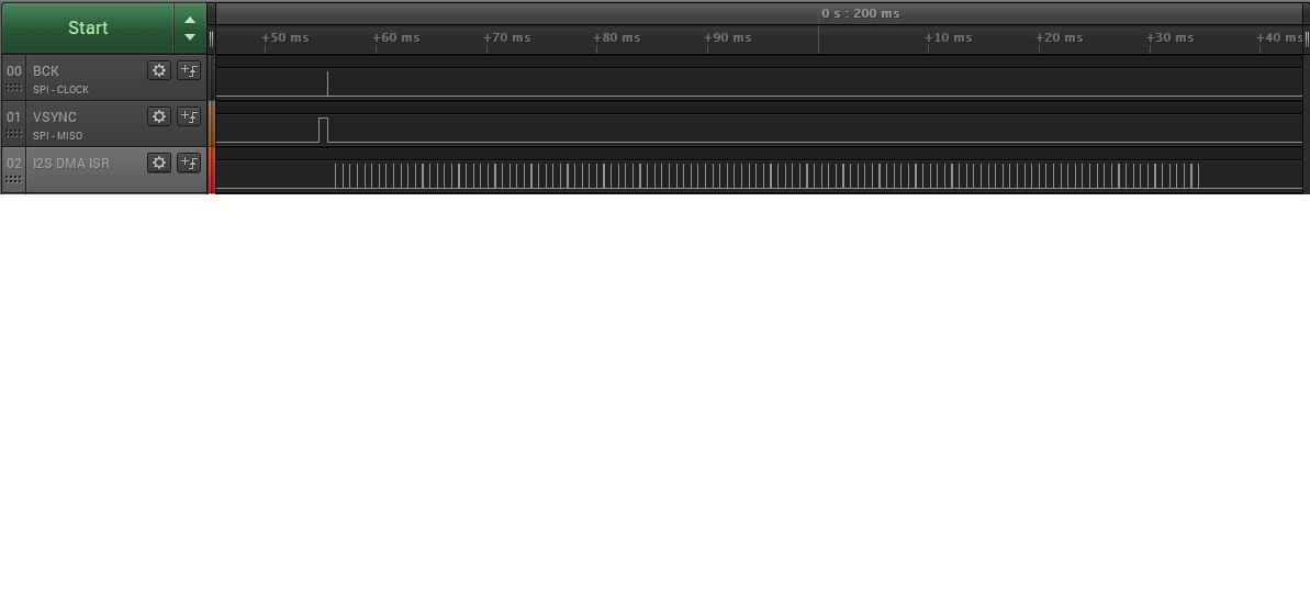

Hi kolban,
Thanks for the reply. It gives hope that someone can help me out
Regards to using I2S in Master Rx in LCD mode, I think it is not supported yet because the datasheet says LCD Master Transmitter and Camera Slave Receiver when it mentions LCD mode of I2S. Actually, I tried to modify this demo code https://github.com/har-in-air/ESP32-LCD ... aster/docs in which I enable RX operation (eg, dev->conf.rx_start = 1;) and check clock signal output, the result is no clock output. When I re-enable TX operation (eg, dev->conf.tx_start=1) like the demo, the clock signal is avaiable. That comes to a conclusion that LCD mode does not support RX now.
Next, I tried to use Camera Slave mode, I modified the demo https://github.com/igrr/esp32-cam-demo in which I change I2S0.conf.rx_slave_mod to 0 for Master RX mode and configure clock pin to OUTPUT and map to I2S0O_WS_OUT_IDX signal.The result is that ESP32 can go to I2S interrupt when DMA transfer done as usual but when I probe the clock output signal, there are few pulses which does not make sense to me
Here is my code to init I2S:
And the code to init I2S pins (I fixed HSYNC, H_ENABLE signals to 1 and only connect VSYNC signal)
I also attach the waveform.
Should I miss anything?
HuyK

gpio_setup_out(CAM_PCLK_IO, I2S0O_WS_OUT_IDX, false);
}Should I miss anything?
HuyK
- I2S_Camera.png (22.63 KiB) Viewed 11120 times

I check the datasheet, it says about Camera Slave Receive mode, it seems that ESP32 could not support Camera Master Receive mode
If so, I need to build an external oscillator that supplies clock to both I2S's clock and FIFO data read clock.
