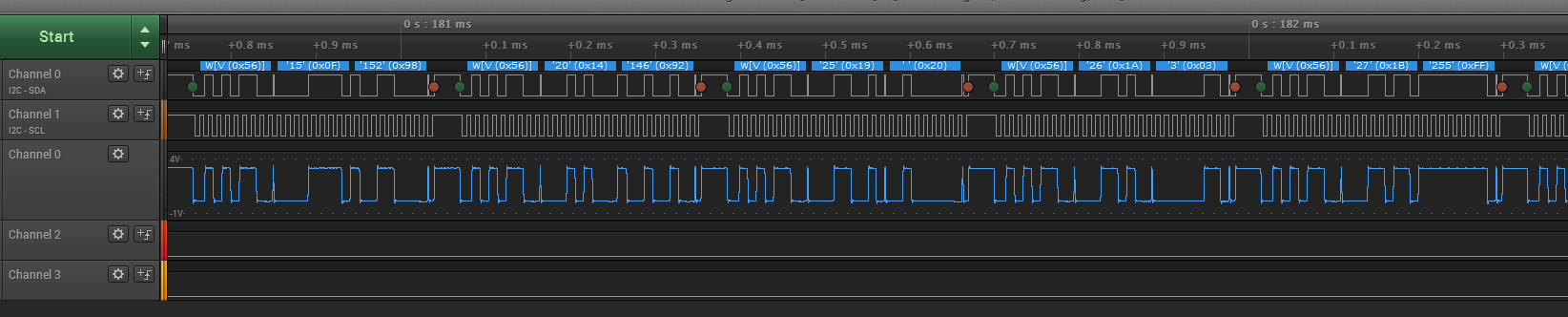

Hi
I'm using an esp32 at 40mhz with only one i2c device on the line, a led controller , LP55231.
Randomly the led stop displaying at all, or make some of the led with random color when they should be black. and 2 secs later without changing anything, all is perfect.
Attached a screen shot of my logic analyzer. all led are black when they should not. Every i2c is ACK but it's not the result i see.
This device is used on arduino or tinsy with no problem do you thing there is something particular with the esp32
Thanks ?

What I2C clock frequency are you using?
Looking at the data sheet, it seems that the max is 400KHz ... but that is the max. Can we try at a lower clock frequency?

Using 100khz
When pushing regularly
// Set enable bit
WriteReg(REG_CNTRL1, 0x40 );
// enable internal clock & charge pump & write auto increment
WriteReg(REG_MISC, 0x53);
It seem to fix it. it was random before, but with that for the instant i don't have it. I can't find any people having the same problem on arduino
