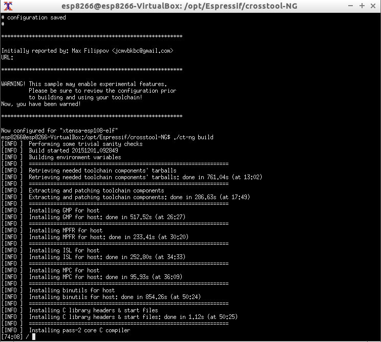

hi guys
Toolchain compiled
Toolchain installed
ESP32 SDK 1.0 installed
User Project created
User Project successfull compiled
done!
BUT!
I can not test - i have no Modul -
so - please feel free to download the Firmware for ESP32
and test, let me know if all ok ;-)
and if you can post a picture from output
this will make me happy //
if fw goes wrong, please delete and do not make Picture :lol:
done!

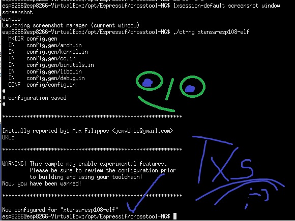

and so, i had a try in this night for Linux User Group at "Windows"..
like you can see, we can use the same VM and the same Lubuntu File like esp8266.
( Dbg must be improved manually a little in my situation. but we can check build log and we can see what we must do manually for this tool , will talk later time to jcmvbkbc what the best way is.. will update then here, i do update Lubuntu too in this way )
Here , where i work this week, i have no Linux PC, so i installed VM and Lubuntu img.
The Install description under your linked SDK is simple to do the same thing.
The Install proc. for toolchain had a duration ~ 3 h, so be still patient at compile, install, cross tools and so on.
I must work next time here at business, so i can not try 8-12 days in this next time at home PC, i had a chance this night to do this, so i try and : Done! ;-)
txs and credit goes to jcmvbkbc alias Max Filippov for the tools!
and espressif for the SDK.
