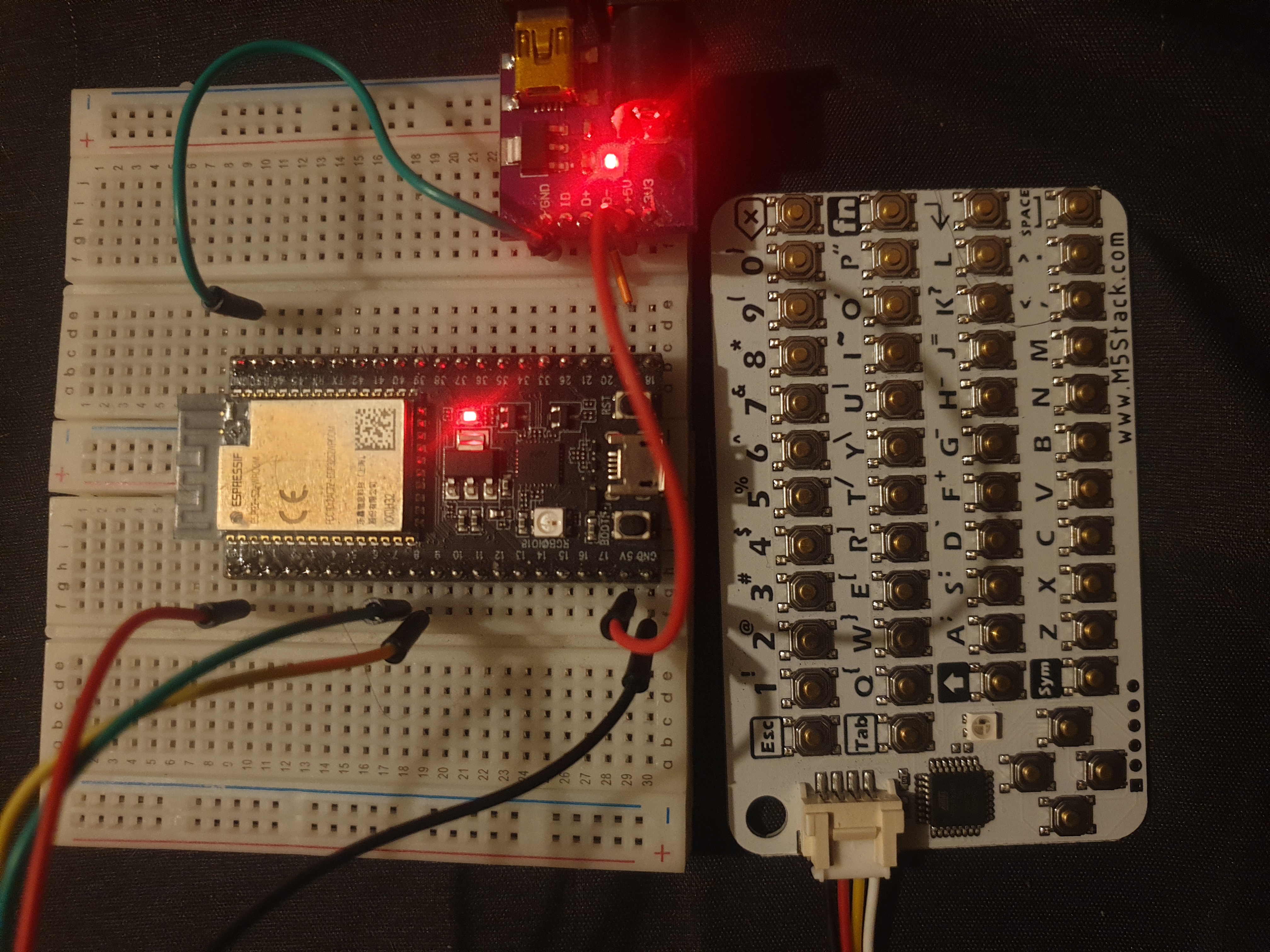

Postby chegewara » Wed Dec 30, 2020 11:09 pm
Very simple example of USB HID keyboard with saola board and m5stack cardKB. Code will be available on arduino and is very simple and easy to use:
#include "hidkeyboard.h"
#include "Wire.h"
#define KEYBOARD_I2C_ADDR     0X5f
HIDkeyboard dev;
void setup()
    Serial.begin(115200);
    Wire.begin(7,8);
    dev.begin();
void loop()
    delay(10);
    Wire.requestFrom(KEYBOARD_I2C_ADDR, 1);  // request 1 byte from keyboard
    while (Wire.available()) {
      uint8_t key_val = Wire.read();                  // receive a byte as character
      if(key_val != 0) {
        dev.sendChar(key_val); // send ASCII char

Postby chegewara » Thu Dec 31, 2020 10:28 pm
Library is updated with mouse and gamepad, so now its possible to build hid devices:
- keyboard,
- mouse with 2 scroll wheels and 3(5) buttons,
- gamepad with 16 buttons and 2 analog joysticks,
- some generic IN/OUT hid device.
Unfortunately only hid 1 device can be implemented at the same time, because arduino tinyusb library is build with such settings.
Happy new year with esp32 and wish you all many great projects and new esp32 chip versions in 2021.
