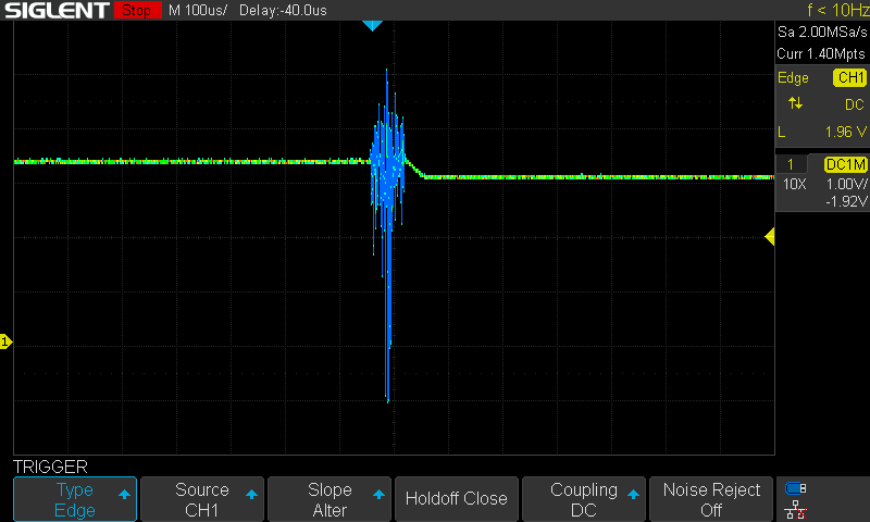

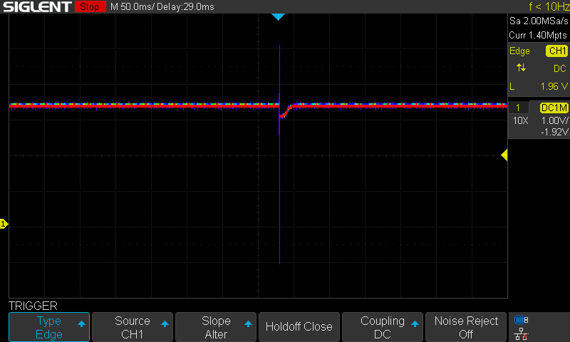

Just had that very same issue, trying to investigate with a scope but either it's really random or as soon as I plug the scope it doesn't happen anymore :lol:
Edit: there we go!
