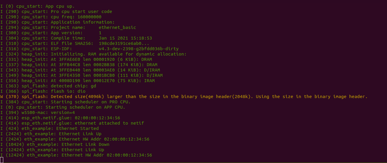

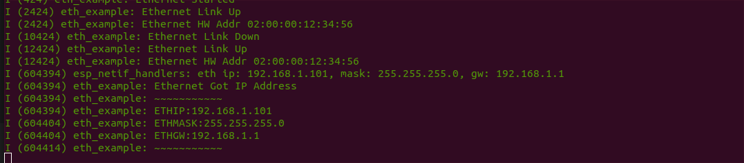

Hello everyone,
I am working on example Ethernet basic with external chip W5500 by SPI;
I use new posibility cooperate with W5500 by SPI, which hasnt fix description and documentatnion yet, but menuconfig has this option. It was added in November 2020.
I have started example code, but I can't get IP addres. The program is waiting. The program has reaction for LinkDown and LinkUp so its event handler (for ETH events) works. Probably some problem with GOT_IP event exist. I use ESP-IDF 4.3-dev-1901-g178b1222c1
I dont know why, I tried to run on 2 routers (both with DHCP). Could I need modification some field in mac/phy strutcture which are use to make a object to install driver? Or maybe some timeout is important?

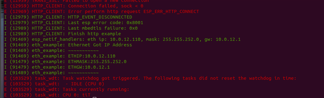

Sometimes (I have noticed 2) the application has connect (pls look into screen), but I don't know why.
And it was happed after really long time. When the ESP32 has IP address, the computer in the same subnet might ping ESP32 but delay is enormous.
In logs/documentation from example it is show, that (getting IP from DHCP) spent time about 2 seconds.
Do you know how to change code to check static addres?
Do you know is might be problem with my ethernet subnet?
How check it to debuging this problem?

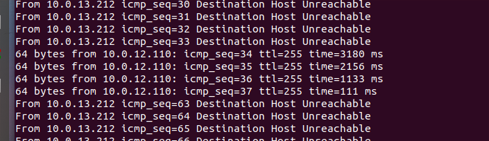

- somtime ping "works" but delay is too long
- Zrzut ekranu z 2021-01-13 14-39-09.png (61.85 KiB) Viewed 18874 times

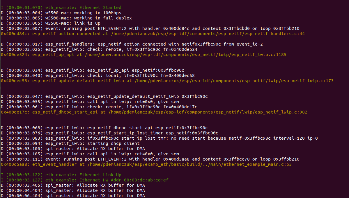

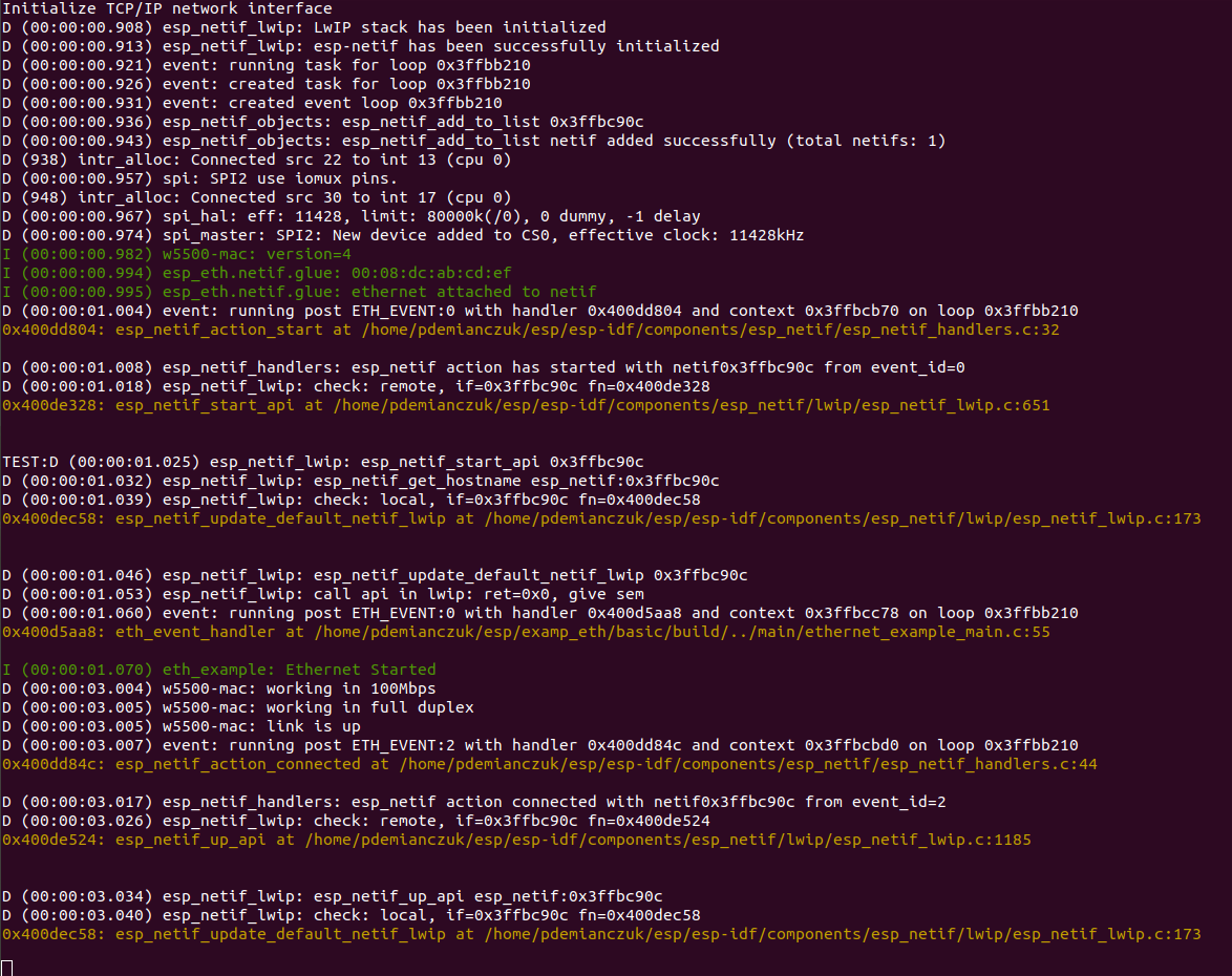

update:
I changed loging to higher level and notice some information form esp_netif component.
If I have good know the link is good (fullduplex mode) ane ETH_EVENT 2 -> ETHERNET_EVENT_CONNECTED Could anyone know what might mean:
esp_netif_lwip: if0x3ffbc90c start ip lost tmr: no need start because netif=0x3ffbc98c interval=120 ip=0

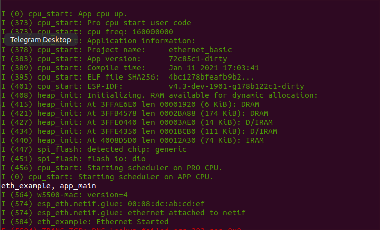

Hello @pdemianczuk
I can confirm that the 'basic' example works for me. I had to lower the SPI clock speed to 20MHz (was 36MHz by default) and I've set the GPIO for PHY Reset to -1 (not used). The W5500 module I am using did work w/o interrupt line connected when used in an Arduino environment, but with ESP IDF I had to connect the interrupt line else I could not ping the module from the PC.
Some questions:
- What is the reason you are not using the latest available IDF 4.3 version, eg. v4.3-dev-2398-g2bfdd036b? Not sure it matters though.
- Why is there a HTTP_CLIENT in your log? A previous test? Another task running?
- Have you double checked the wiring between ESP32 and W5500 is good?
- Have you double checked the power supply is strong enough?
- Have you double checked the Ethernet cable is good?
The lines I've connected between ESP32 and W5500: 3.3V, GND, SCLK, MOSI, MISO, CS and Interrupt

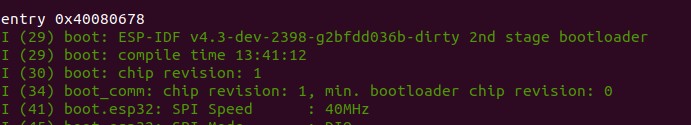

hello @felmue
indeed about esp-idf version;
I have the latest version but I have compiled only app (not build all project) so in first log I see diffrent version. I fixed this According to http_client componetns I have call this from event handler with GOT_IP, so I think it is rather correctly.
But you are right, probably it doesn't make sense.

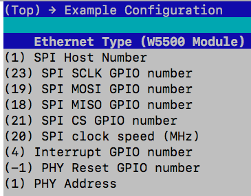

- Zrzut ekranu z 2021-01-15 14-18-32.png (20.38 KiB) Viewed 18823 times

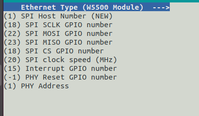

Hi @pdemianczuk
I'd test without http_client until the basic connection is properly established and stable and can be pinged consistently.
I noticed that you have the same GPIO18 defined for SCLK and CS - an oversight? That would certainly explain things.
No, I did not use the reset pin. In menuconfig I only made changes in the Example Configuration:
Thanks
Felix

In reference to your post, I had made next instance of project on example and I did this mistake. Thx for your attention
but the problem with IP is still exist Could share your sdk file? maybe some setting is LWIP section is imporatant.
update: it have connected.....after....604 sec....

Do anyone know what could be interesting in this log?
I see something in DHCP frame with string "espressif"
