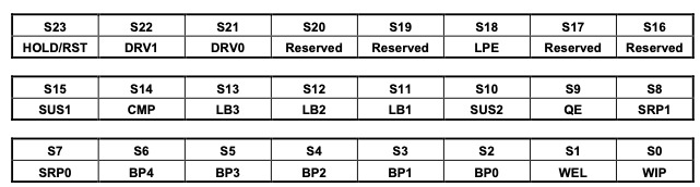

I'm using the GD25Q127 flash chip from GigaDevice and I checked the 'esptool.py read_flash_status --bytes 3' and it gave me '0x4000fe' Which is 010000000000000011111110 and the last two bits are Write Enable Latch and Write in Progress respectively. According to the datasheet(Page #14 attached), if the Write Enable Latch is 1 then you can write to the chip and it can accept erase command. So essentially this chip is not write protected. Am I reading this correctly?

The Chip Erase (CE) command is executed, only if the Block Protect (BP2, BP1, and BP0) bits are 0 and CMP=0 or the Block Protect
(BP2, BP1, and BP0) bits are 1 and CMP=1.

You are right @WiFive. I missed that in the datasheet. Thanks for pointing that out. I wonder how that happened as I haven't purposely change any of the status register values before. Anyway, My new flash chips arrived and I just tested and it works fine. I checked 'esptool.py read_flash_status --bytes 3' and returned '0x400002' which is '010000000000000000000010' and writable according to the datasheet. Above BP2, BP1, and BP0 bits are 0, and WEL(Write Enable Latch) is 1.
