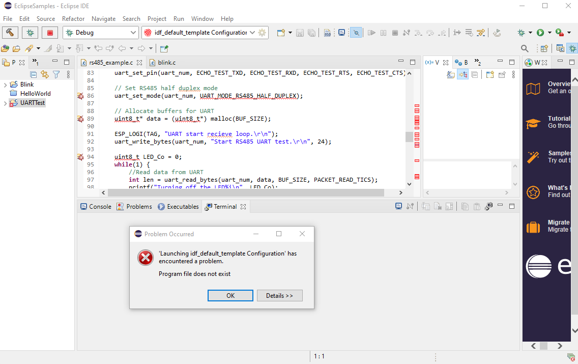

I've difficulties with the dubugger. I tried it in VSCode
viewtopic.php?f=40&t=19050
I tried it in Eclipse - see picture.
How works the dubugging for esp-idf?

If I try to start the openocd with cmd.exe I get ths answer:
and then the cmd.exe hangs up.
I found ths site:
https://docs.espressif.com/projects/esp ... un-openocd
This speaks about libusb. I think that means the driver. I did install the driver with zadig.
What ca I do for this?
I've a wrover Kit v3 and I've connect the jumpers like here:
https://docs.espressif.com/projects/esp ... up-options
How can I configure the scan chain? Where I can find that?
c:\ESP32\.espressif\tools\openocd-esp32\v0.10.0-esp32-20200709\openocd-esp32\bin>openocd -f board/esp32-wrover-kit-3.3v.cfg

Error: libusb_open() failed with LIBUSB_ERROR_NOT_SUPPORTED
Info : ftdi: if you experience problems at higher adapter clocks, try the command "ftdi_tdo_sample_edge falling"
Info : clock speed 20000 kHz
Error: esp32.cpu0: IR capture error; saw 0x1f not 0x01

Error: JTAG scan chain interrogation failed: all onesCode: Select all
Error: Check JTAG interface, timings, target power, etc.https://docs.espressif.com/projects/esp ... up-options
Error: Trying to use configured scan chain anyway...Re: Can't really help anyoen - the idf-openocd debugger don't work
Your software seems all in order. That error is something you get when there is something wrong between the JTAG adapter and the chip. Can it be that you have software running on the devboard that reconfigures GPIO12-15 to something else? That breaks JTAG communication as those GPIOs are the ones the JTAG signal normally is on.

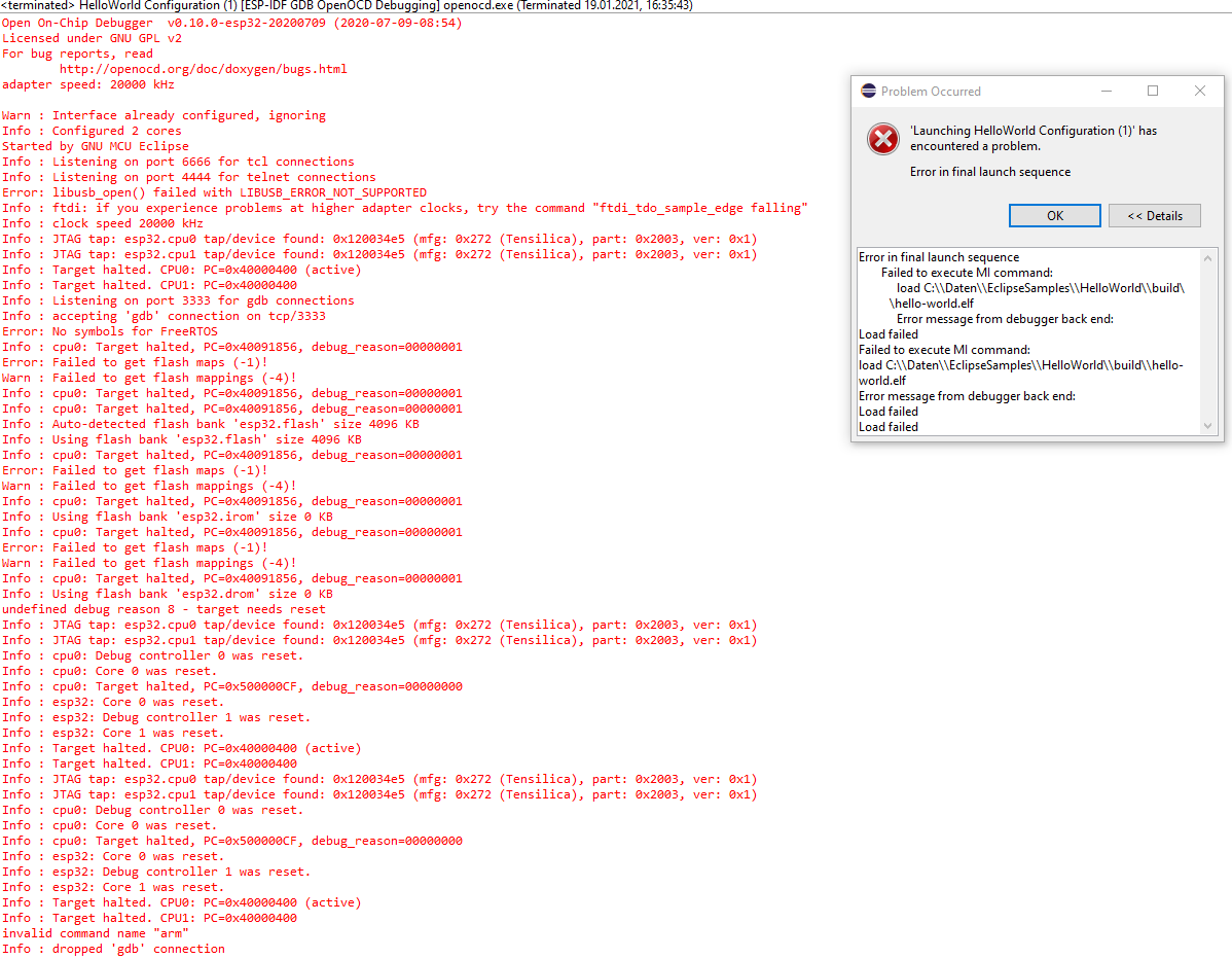

I used then the hello_world example. The result was the same. I found this site:
https://docs.espressif.com/projects/esp ... ugger.html
and worked trought that. But on the question of target is fini. This document doesn't allow a seial or USB connection. Now I have in the debug config the option 'ESP-IDF GDB OpenOCD Debugging and I maked here the same like in the document. But in the tab 'Debugger" he offers a GDB port.
But the result you can see in the picture.
Well, openocd works like a charm - that looks like a good JTAG connection. However, I'm not sure what you have connected to OpenOCD but it looks like that is expecting an ARM CPU somehow, not an Xtensa. Are you sure that whatever you're trying to do the debugging with supports and is configured for the ESP32?
