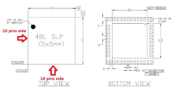

Ok, so now there is another issue with the latest manual:
I can confirm from inspecting the part that it matches the first diagram. The question then is, is the second diagram wrong, and therefore are pins 1-14 on the long side?

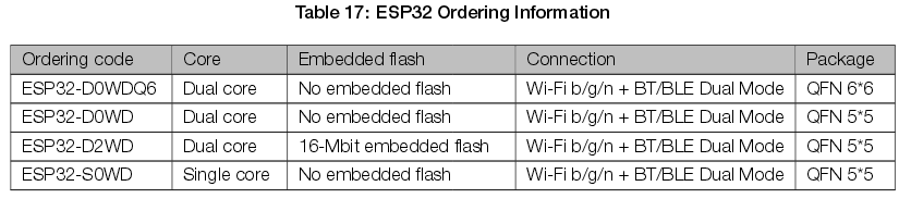

Yes, plus it has built-in 2MB? flash in D2 configuration, so it's more secure and much smaller overall.
D2 would be 16 Mbit
Embedded Flash
0=No Embedded Flash
2=16 Mbit

what can you say, the marked pin1 point is this on the 1o pin side or on the 14 pin side,
do you think this can be the right :

The pin 1 dot wouldn't line up with pin 1 if it was on the 14 pin side...

Right, but I have actual parts and they match the diagram that would indicate it's on the 14-pin side. That is the problem.
