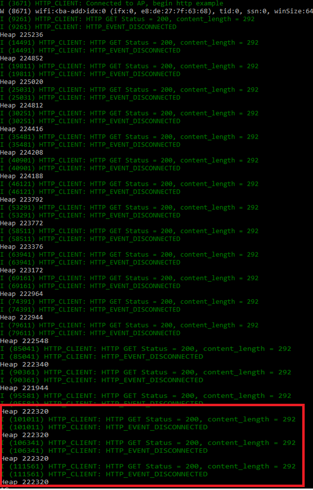

Hello guys,
I have a doubt with the handling of the heap when using esp_http_client.
Every time I make a new request, the heap decreases (I attach the image) after several requests the heap remains at a static value (red box in the image), this last value is what I would expect since I am making the same request with a very similar answer.
What is the reason that when making a new request the heap decreases?
I already checked and I don't have any malloc without free() ... is there a reason for this to happen?
I am relying on the example of esp_http_client... I attach my code
esp-idf: v4.3-dev-2586-g526f68239

boarchuz
Posts: 656
Re: doubt with memory when using esp_http_client
Postby boarchuz » Thu Jan 28, 2021 12:52 am
Don't dwell on it, there's no leak if there's not a consistent pattern of reduction.
See this post: viewtopic.php?t=14056#p55646
And also consider that there are other tasks doing work behind the scenes - especially WiFi/lwip in this case, which will be dynamically allocating/deallocating buffers as required.
