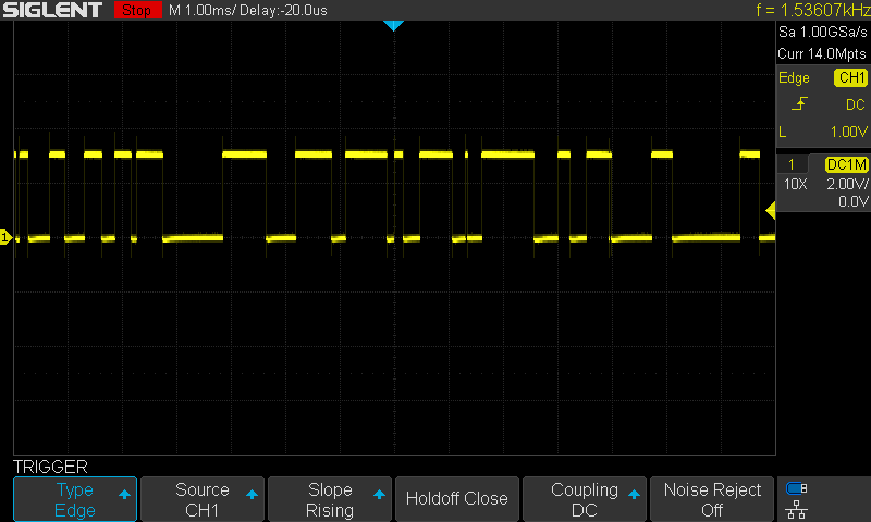

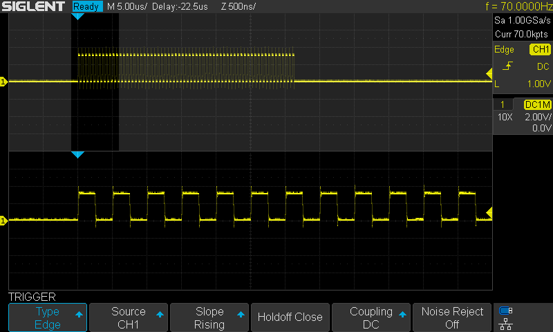

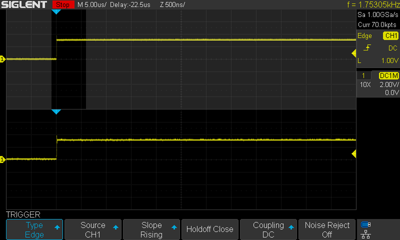

I want to generate a waveform with 194 steps using 4 blocks of the RMT internal memory.
Everything works fine with 64 steps or less, but adding additional steps produces invalid waveforms.
The SDK does not return any errors though.
I created a minimum "not working example" with a clock output that reproduces the problem.
Results and source below. What am i doing wrong here?
Waveform with <= 64 steps (OK)
Waveform with > 64 steps (nOK)
Waveform with > 64 steps, zoomed out (wtf?!)
Sourcecode

The check in the 3rd line caps the items to 64. Writing more than 64 items is no option here. Since my source has no stop line in the first 64 items, the transmitter dont stop at item 64 and sends uninitialized data instead.
I solved the issue by rewriting the check to this:
static inline void rmt_ll_write_memory(rmt_mem_t *mem, uint32_t channel, const rmt_item32_t *data, uint32_t length, uint32_t off)
    //length = (off + length) > RMT_CHANNEL_MEM_WORDS ? (RMT_CHANNEL_MEM_WORDS - off) : length;
    length = (off + length) > (RMT_CHANNEL_MEM_WORDS * (8 - channel)) ? ((RMT_CHANNEL_MEM_WORDS * (8 - channel)) - off) : length;
