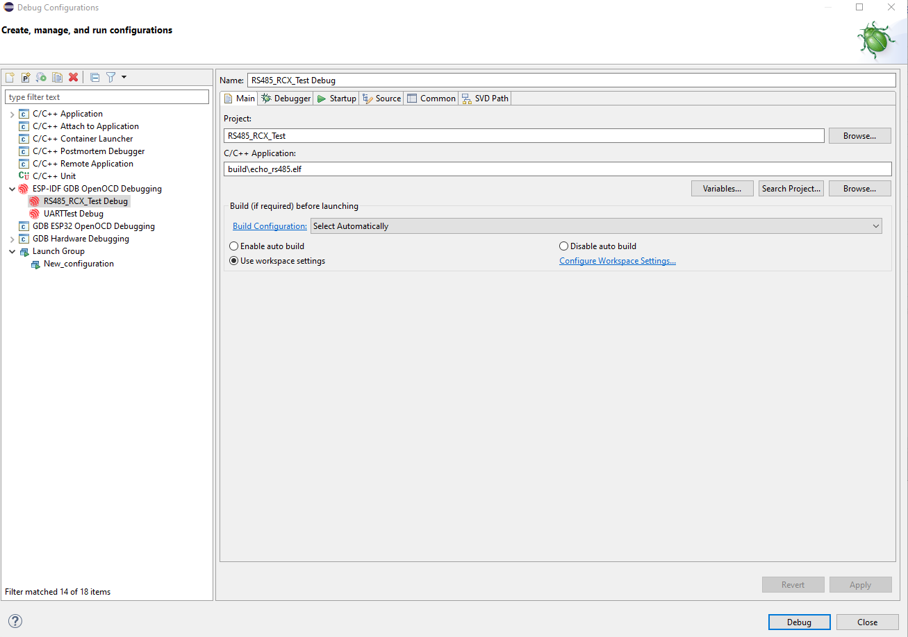

Re: ESP-IDF in Eclipse for C/C++
So, a resumeè.
First, one must pay attention to the paths. If there a net drive - leave it! Make all in the C:!
Second, this here:
https://docs.espressif.com/projects/esp ... mmand-line
is nonsens. No way.
If you have install the ESP32-plagins in the Eclipse, then test with the hello world or blink or so! If this works, then take the option "ESP-IDF GDB OpenOCD Debugging" and create (double click) configurations only here!

- 2021-01-28-16-16-14.png (58.33 KiB) Viewed 3777 times
