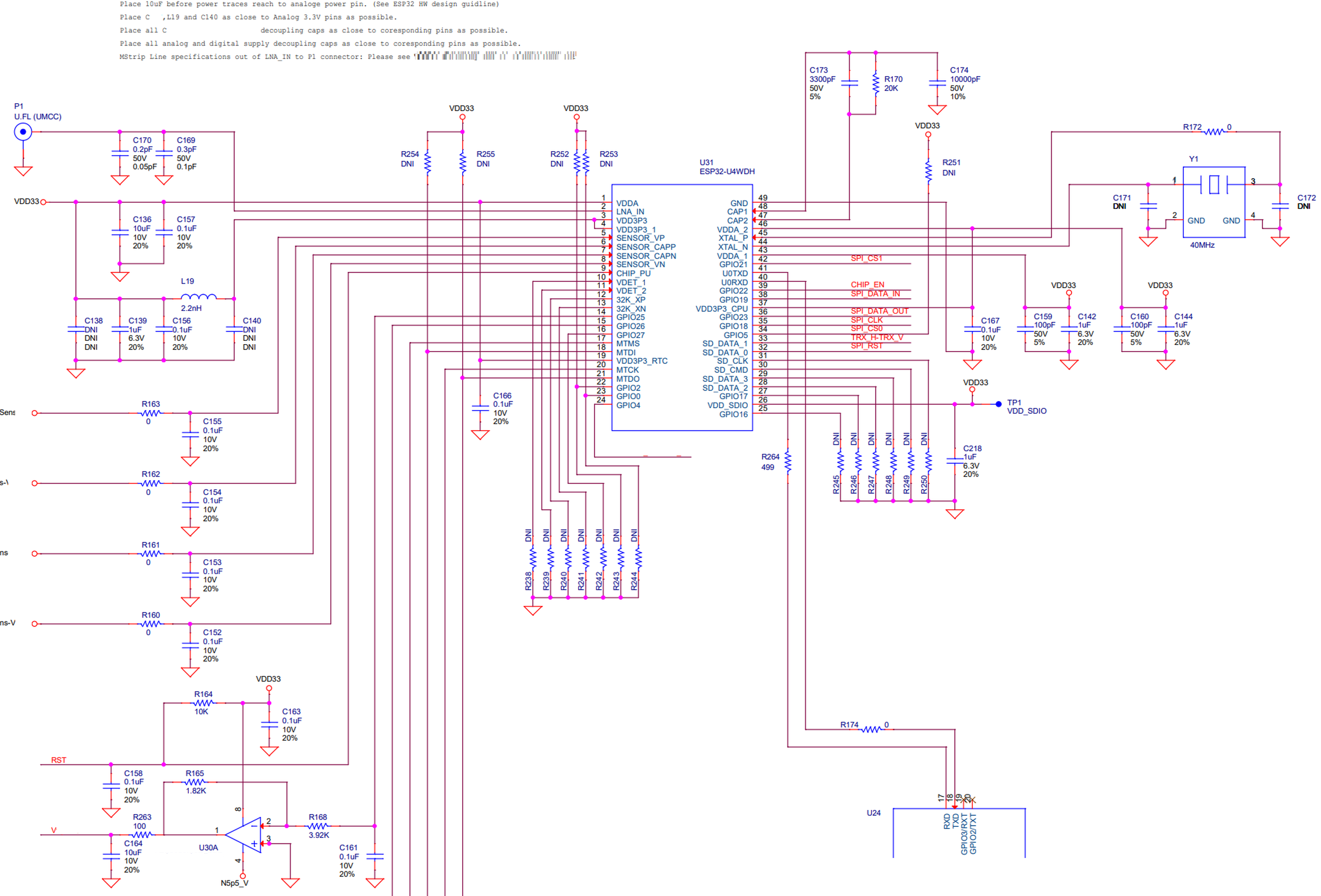

Wi-Fi - single core softAP on v4.0.1, 4.3 (master), and v4.0.2, SSID shows up and connects, using DevKits ESP32-SOLO-1 or WROOM-32D or 32U
Same binary also works on U4WDH in two modified Solo-1 (removed S0WD, installed U4WDH).
Same binary fails Wi-Fi on my prototype using U4WDH as softAP.
SSID appears intermittently. I cannot connect to it from same machines that work with DevKit
I set for single core with menuconfig, and verbose debug, verbose Wi-Fi debug, etc., as seen below. I’ve built 4.0.1, master (4.3) and 4.0.2. All similar results.
To isolate, I disconnected other parts of circuit and power up only 3.3V and (USB supplied 5v for uart interface). I then see ets_main csum error in boot loader. Is there any obvious strapping problem here?

If I come back an hour later, try to connect again, again there is no debug output, until 6 minutes later, similar to the above is seen. Again half an hour or two hours later, I can do the same again. This would seem to be a software problem in libnet80211.a, except for the obvious problem I fail csum if I try to power only the ESP32 chip and USB. So I am thinking something is interfering with strapping or important thing happening on multi function pin.
